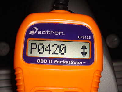

I was having a wonderful earning morning drive to work just now... The car felt good and the traffic was very mild (well, it was like 5am). As I was enjoying the drive, I saw a yellow light come on... Yes, another CEL/MIL.
I am very confused now. What can be the source of this problem? The one who can figure this out gets a hug from me.
Yes, it is P0420 code (Catalyst System Efficiency Below Threshold) again...
