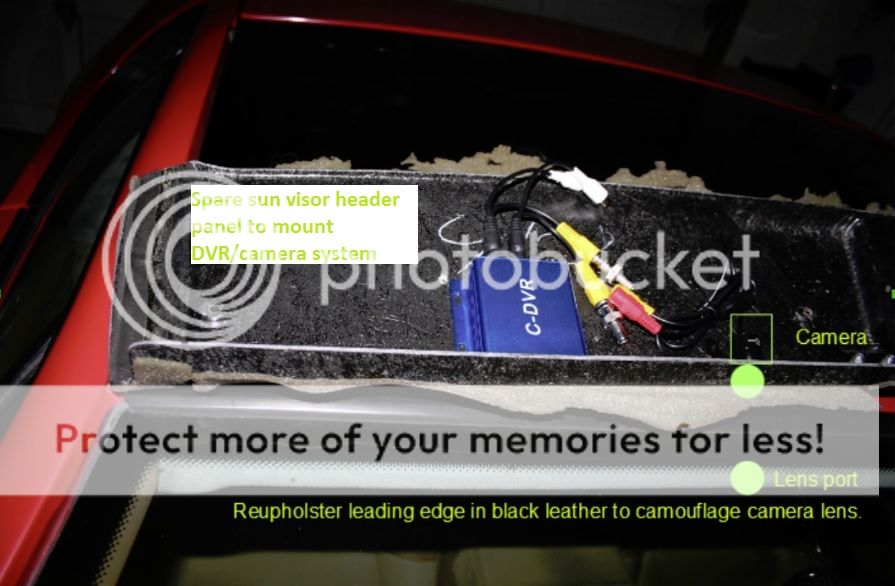

I've removed the header before - it's held on by what appears to be four 1.5" sheet metal screws (!) directly into raw fiberglass/kevlar. That handle will definitely not work in that location.
I bought a separate header piece (to keep the original intact) where I plan to put a DVR/camera and my RADAR detector in a discreet location (to prevent smash and grab thefts).
Will post some very early stage pics later.
Here is my initial UNINSTALLED header piece with the DVR and camera shown next to the INSTALLED header piece.
Could you share with us the thought behind a forward facing camera installation?
