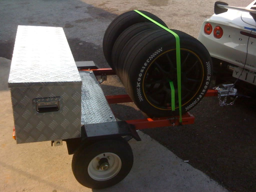

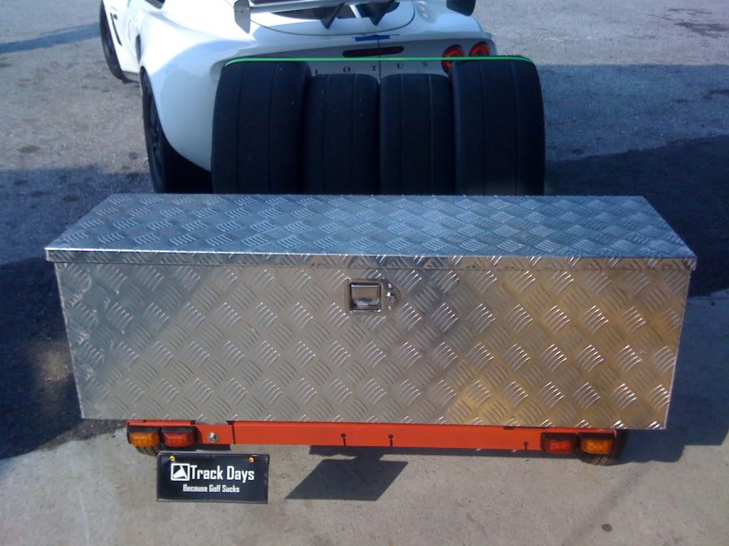

Nice looking set up. What's the tongue weight with the tires up front?
You must have some heavy stuff in the box. How far is the tow?
I would guess maybe 40-50 lbs on the tongue weight... Box has a lot of tools, aluminum race jack and small air compressor in it. I would guess the total weight on the trailer to be around 250-300 lbs or so. I'm going to make a mount for a scuba tank to fit some where on the trailer and then use a reg to drop the pressure down to 120 so I can run some air tools. Also have a few more things I want to do to it as well.. The tow is about 70 miles or so and the last 2 miles are up a mountain with lots of curves and rough roads, but I still took it pretty quick with out any issues.
