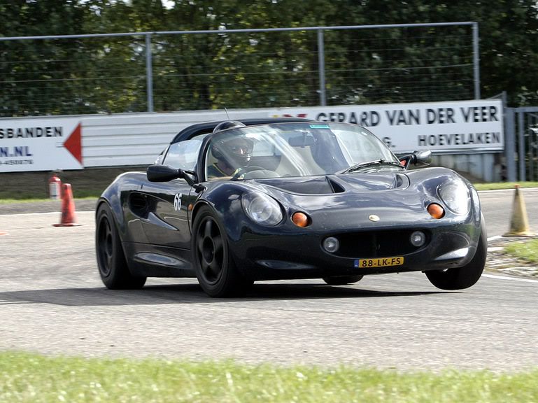

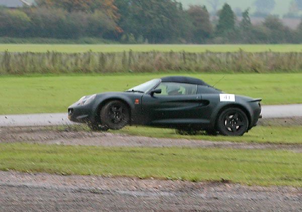

you all seem intent on missing the point.
It's not about changing the dampers to some after-market (ALA Nitrons/Ohlins/etc) it's about getting the wheel travel and limits right.
FYI, the two pics are NOT kerb-hopping, that's steady state cornering, what I was trying to show, (and clearly failing) is that you need to get the car to lift the front wheel BEFORE the rear, if you don't, the rear will unload.
In stock form, this is what happends, its supposed to do this as it's safer like that for 99.9% of numpty drivers.
the way to change the damper lengths is to move the damper mounts if you can't change the dampers themselves, by either new brackets (and there are several Lotus ones as well as many non-lotus ones) thus changing the static point in the stroke of the damper (you can also use droop limiters if allowed).
you then change the springs to suit so that the static ride height is back where you started etc (there are more then one rate of Lotus spring if you feel you *have* to stick with Lotus stuff), in any case you telling me that you are going to have the springs inspected at every event? (and who here can tell what a spring is by looking at it?)
Also, comparing the use of an LSD on an Elise vs. a Miata (MX5 to us) is dumb, the MX5 is Front engined and not transverse, so it will suffer torque reaction to the rear end, hence an LSD is essential (much the same for the Caterham etc).
Last point,
you clearly have no idea what cct racing is about, and think I don't understand autocross, Look, which country do you think invented it? do you not thing we have the same sort of competition here?
it's irrelevant what the event is, if your getting wheel spin in tight corners, it's the same wheel spin, and required the same solutions.

As I understand it, to run the Elise in a *stock* class the car must remain essentially stock. *But* you can bolt on any factory option Lotus offers. So if for example Lotus produced a handling package for example that greater increased the range of adjustment for camber, this would be ok.
Although it would be possible to cheat a dramatic improvement in times would not go unnoticed. And having read lots of AutoX threads here, some competitors will go to any length to protest the smallest infraction even if it brings no performance benefit.
Given the popularity of AutoX in the States, I think Lotus has listened to some degree by bringing in the LSD, although I think developing a factory option geared towards AutoX would be more productive i.e. sorting out the dampers/springs and increasing the range of camber adjustment.
My car which has run in a lot of AutoX type events here in Europe does not get a lot of wheel spin if any from tight corners due to the back wheel lifting - what wheel spin there is tends to come from a lack of control with my right foot.
This photo I guess shows what Simon means by the correct setup. The car is running stiffer springs, nitron dampers and a 3 x stiffer ARB. Front wheel is lifting but the back wheel is still hanging in there.
An even better example is here.
Just a little unforturnate I'm going backwards at the time
Here's a vid of a run at a Dutch AutoX - Clicky

Like this?

Stan, when I first got started I did run the car completely stock standard. I did OK normally in the top 3 but never 1st. I was always up against other Elises with a 40hp advantage and/or Nitrons. When I swapped to Nitrons, I started winning on a regular basis despite the power difference. Of course the driver is a major factor in any Motorsport event. The S2 suspension was a major improvement over the S1 and many S1 owners have upgraded their cars with the S2 bilstein dampers and springs, Nitrons are an incremental improvement over these.
But all this is fairly meaningless to your situation. What really needs to happen is for you guys to get friendly with Lotus USA and try and encourage them to produce a factory option specifically tailored to AutoX requirements. They would be stupid to ignore this important market segment. After all win on Sunday sell on Monday...

Originally Posted by Stan
Like this?
Ding, question is what is the back inside wheel doing? Can't see it well in that shot.
