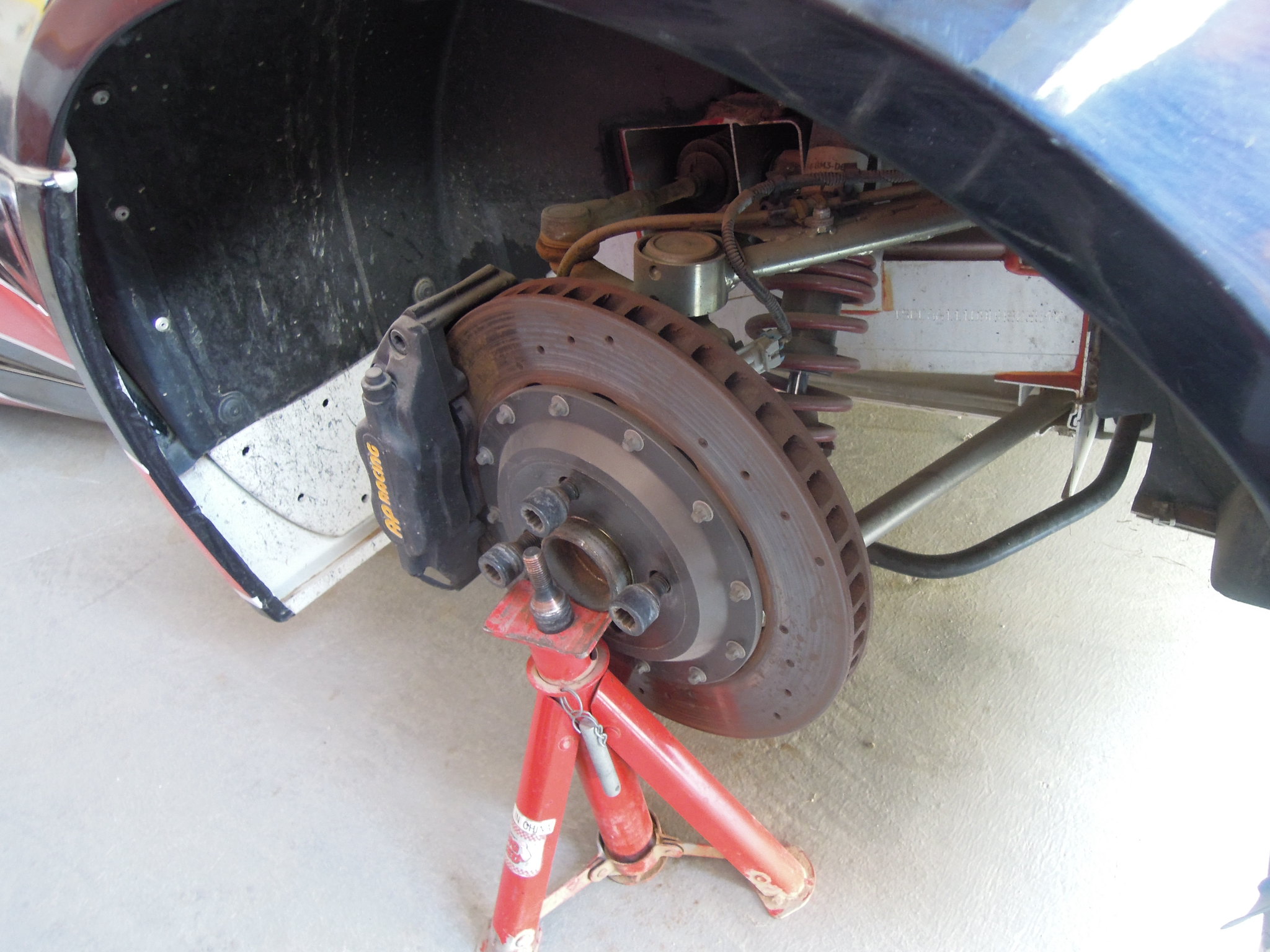

I run since many year Alcon disc mounted rigid to the aluminum hat (custom made) wo issue. My disc operation temperature is between 1100 and 1300 F. The disc dia are small enought and rigid mounting seams like working properly.
