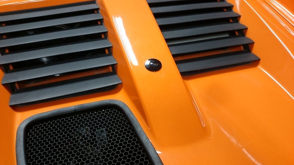

So this thread inspired me to finally do a quick latch install. I got a black Quick Latch Mini and a piece of aluminum and did this in about 40 min. Saved about 1/2lb or more and the best part is that I can open the boot without having to turn the car off to use the key!
Stuff that was removed:
The quick latch button from the top. The key hole was almost exactly the right size for the quick latch. Serendipity.
A pic of the piece of aluminum that I cut, drilled, and bent. (there's your fab)
Here's a pic of the underside. I might make a little wall that helps seal off the trunk from the engine bay. I don't want my air filter pulling in hot air.

Not locking though. Are you concerned someone will break in?

Posts: 1,153
My car is a dedicated race car.
That makes it easier. I like this solution for things like clam removal and such. How secure do you think it is? The aerocatch I know does high speed.
