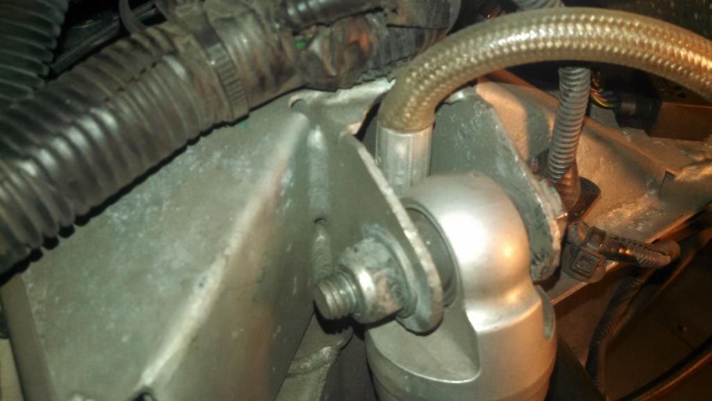

Forgive the new-to-Lotus question: how are you all getting 2.0/3.0 degrees of rear camber?
I would love to fit a 17x9 in the back but now I'm getting worried about clearance on the remote reservoir hose on my DA ohlins. I've heard you can flip them, assuming that fits in the other direction too. I may be waiting for someone braver than I to get a set of the 949 wheels in 17x9 and post how they fit.

Join Date: Oct 2011
Location: Hyattsville, MD

Yes, you can flip the DA Ohlins. The caveat is that you have to grind out a bit of the subframe to allow the hose to clear. It's not that much grinding and I did it with a grinding attachment on a drill. See the pic:
glagola1 is offline
post #99 of 283 (permalink) Old 10-06-2015, 01:00 PM
user /tron
RideMooch's Avatar
Join Date: Jul 2006
Location: Hillsborough, NC
Posts: 880
Got it, thanks. That's what I thought eyeballing mine. Any concern that grinding that out would weaken the shock mounting point? I guess if yours is holding up with massive Hoosiers applying the force it's fine.
