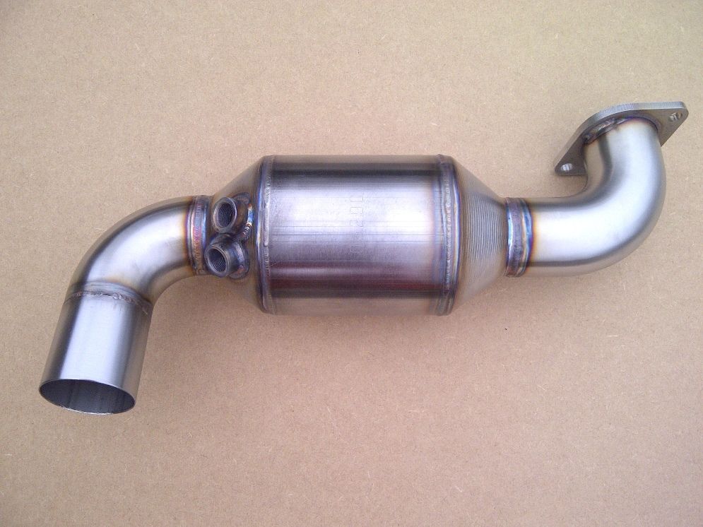

What is/are the difference(s) and advantage(s) of the 200 Cell Sports Cat, over the Stock Lotus Cat, when installed with the 2bular Headers and Downpipe and the Lotus Stage 2 Muffler ?

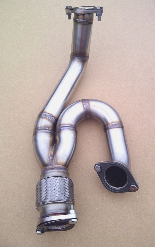

J-Pipe looks beautiful. So it fits in stock postion?
Thank you :)
Yes, the 3 flanges are in exactly the same position as the factory design. I paid particular attention to clearing the undertray! Might produce a tray without the cut-outs if there's enough interest.
I can't speak for exactly this configuration yet, but we found the stock cat already being a high flow cat and so it's not in the KT300 Kit e.g. as not necessary as long as you don't want an even louder car.
On the NA we didn't find more HP or torque after replacing the stock after-cat which actually is not the main cat. The EVORA's main cats are the ones in the exhaust manifolds, some call them pre-cats but actually that's not right.
In any case replacing them is THE key for more power on that engine so I am sure the 2-bular headers with downpipe will work out great even without the 200cell on an NA.
Different story on the Evora S though, where this stock cat "is" at a certain "limit" and replacing the aftercat is advisable.
Best thing over here in Europe is that emissions (if a sniffer test is necessary) are not a problem with the stock after-cat (after fitment of the headers) but problematic with a sports-cat. But it is not important if there is only an OBD test without sniffer. :cool:

As emissions legislation has got tougher over the years, manufacturers of larger/"dirty" cars had to look at adding another Cat in the system. Closer to the cyl head means a quicker "light off" and met the tests for lower start-up emissions. Yes, it's a Pre-Cat before the main Cat. The engines are supplied to Lotus with these pre-cat headers already fitted and looking at all the markets they hope to supply, there was no point in changing them out.
As you say, the factory main Cat (a familiar design) is capable of meeting most emissions tests. This should surely tell you it is the std 600cell substrate? It is NOT a high flow Cat. Komotec (I have a Pavlovian response to that name, whereby I stick another pin in Daniel's doll hanging from the roof of my workshop :evil:) don't seem to offer a downpipe set for this install? He doesn't tell us the dia of his header either? The factory 48mm dia downpipes are a major block to REAL power and if Komotec are sticking with these, then you wouldn't see any improvement with a 200cell Sports Cat replacing the main Cat - the damage has already been done upstream and it's pointless replacing anything else until you tackle that restriction. 57mm downpipes - it's the way to go. :D

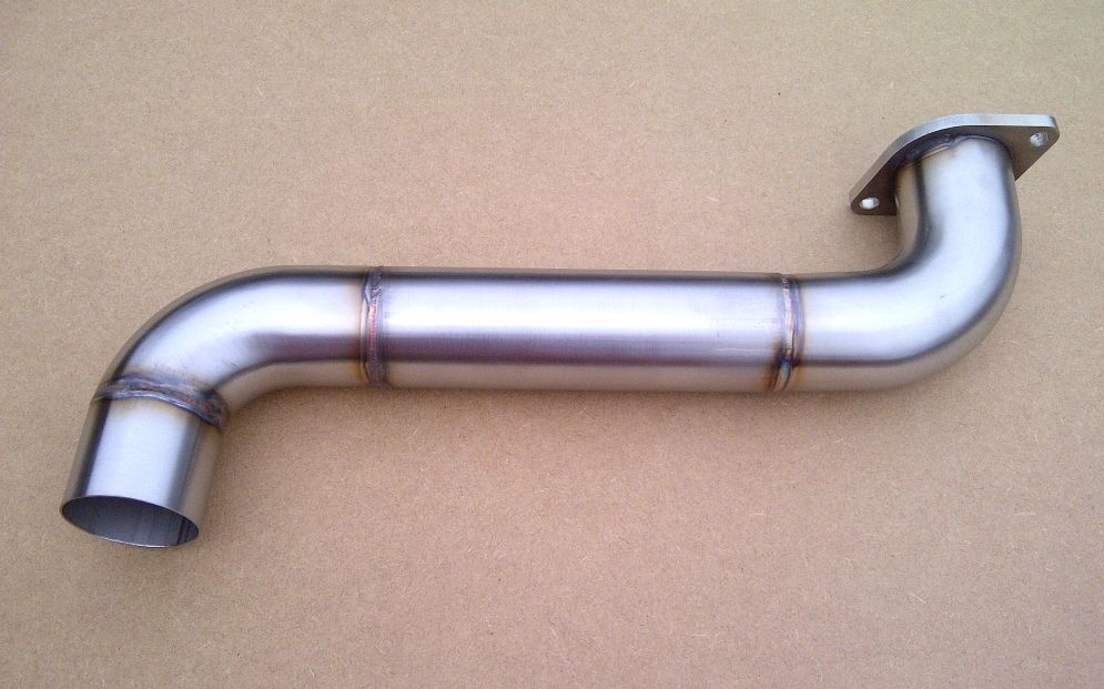

USA Customer? On your De-Cat pipe. My understanding is the Evora N/A has two cats coming off the headers correct? If that is the case your De-Cat pipe removes a 3rd cat? or a resonator? I have the stage 1 factory exhaust from Lotus and I was wondering if your De-Cat pipe would fit without issues? My goal is to gain a little more noise not necessary power. And one last ? would I pass emissions if that small football looking resonator is truly a 3rd cat?;)
3,426 Posts
F: I have taken mine off and looked around the corner and inside and see no "cat" material inside of it and it has silencer written on the side. I am pretty sure that his part will fit your application perfectly.
498 Posts
Cool this has been my suspicion ever since I installed my Stage-1 & noticed the bloated pipe and read silencer/Toyota on the side.:)
1,404 Posts
The main cat is in the exhaust. I read somewhere the pre-cat is only on European models.
1,141 Posts
On the STOCK Evora Exhaust system, there are the "PreCats" in each exhaust manifold, AND the "Main Cat" after the Downpipe "Y" section that connects the manifolds to the Main Cat.
The Factory has the Before Cat O2 sensors at the top of the PreCat Manifolds, and the After Cat O2 sensors in the Downpipes before they merge together. There is NO O2 measurement after the Main Cat. So, with the Stock Manifolds and Downpipe, you can eliminate the Main Cat with a DeCat Pipe, with no CEL, although emissions will rise.
When you replace the Stock PreCat Manifolds with a set of headers, like the 2bular's, KomoTec, or Supersprints, you loose the PreCats. So, now the Before Cat O2 sensors are moved down to the Downpipe bungs before the merge, and the After Cat O2 sensors are moved to the back end of the Main Cat. That is why you see the O2 sensor bungs on the back end of the Metallic Sports Cats, and why you have to weld those bungs into the Stock Main Cat if you just replace the Headers and Downpipe, and retain the Stock Main Cat. Also, that is why you have to lengthen the O2 sensor wires to reach down to the Downpipe and Main Cat bungs. So now, if you eliminate the Main Cat with a DeCat Pipe, you have NO cat at all, and will have to deal with the ECU for the CEL.
5,709 Posts
When you replace the Stock PreCat Manifolds with a set of headers, like the 2bular's, KomoTec, or Supersprints, you loose the PreCats. So, now the Before Cat O2 sensors are moved down to the Downpipe bungs before the merge, and the After Cat O2 sensors are moved to the back end of the Main Cat. That is why you see the O2 sensor bungs on the back end of the Metallic Sports Cats, and why you have to weld those bungs into the Stock Main Cat if you just replace the Headers and Downpipe, and retain the Stock Main Cat. Also, that is wy you have to lengthen the O2 sensor wires to reach down to the Downpipe and Main Cat bungs. So now, if you eliminate the Main Cat with a DeCat Pipe, you have NO cat at all, and will have to deal with the ECU for the CEL.
That was a mouthful, but it makes a lot of sense.. Thank you for the clarification.
