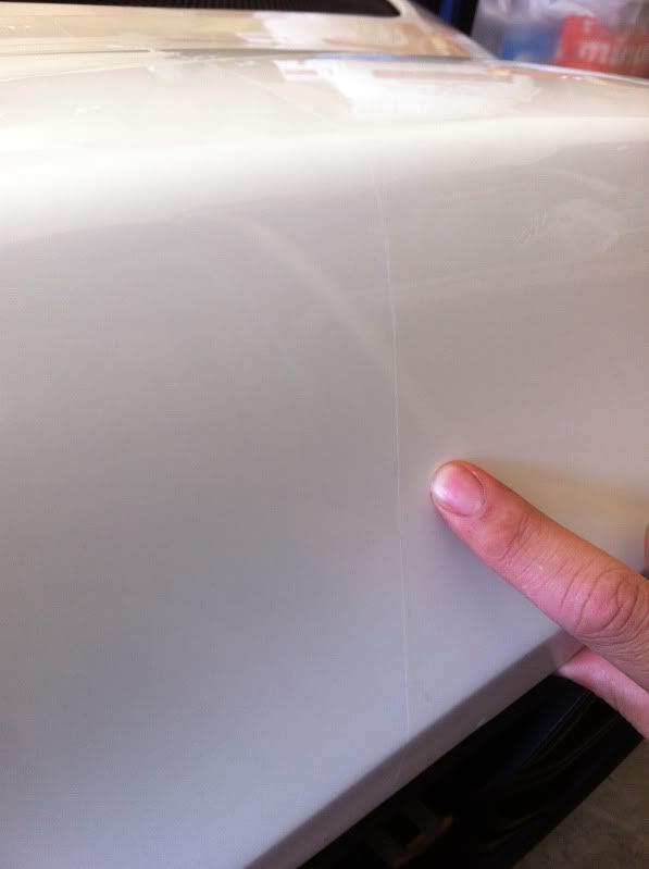

Although the can says 1 can = bumper, 1 can = hood, 1 can = fenders, and etc... One can is actually enough to do the whole front clam. Don't freak out if you see orange peels because that is normal. As it dries, everything will settle and smooth out like butter. Be careful about applying in dirty environment because you don't want tiny bugs or dirt get on your car as it dries so keep an eye out. If that ever happens (like me), get a tweezer and pluck it out.
After you finish spraying, remove ALL tape, bag, and newspaper off the car while it is still WET otherwise, it'll be a pain in the butt to remove it and risk lifting the film/bra from the surface of the car. Once you remove all the tape, newspaper, and bags, let the car settle for a good hour. Again, don't be scared if you see orange peel because thats normal. Once it hardens a bit, bring the car outside and let it soak up some sun for faster dry or if you did it at night (like me), leave the car in the garage overnight to cure. DO NOT DRIVE IT AROUND. Usually takes about 12 hours to fully dry (safe to drive after 12 hrs, but I recommend 24) and a couple of days to fully harden.
Overall, I am very satisfied with the results. There was some runny drips, but that was on my part and its barely noticeable. If you are not satisfied with the bra, you could always peel it off and do it again. I think its was well worth the $30 bucks versus that of the $800-1000 OEM Starshield. Couple thousand miles later, my front clam still looks new!

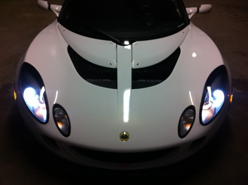

Picture of my front clam 3 weeks after the spray. As you can see, its SHINES!
Safe to pressure wash as well :)
New pics of the clear bra as of 11/14/13 (4 months after being sprayed)
As some of you see, the car still looks good. Doesn't turn yellow like most bras, pressure wash and wax friendly, and smooth to the touch. Difficulty wise one through ten, I would give it a three and i'm not exactly a DIY guy. Its not hard at all, just time consuming with the masking part. If you don't have a starshield, I highly recommend that you to take this alternative. If you have any questions, feel free to ask!
... and here is my car with the 3M clear bra on :)

I had a bunch of orange peels at first when applying the product. After it cures, everything settled and smooths out. There is a small section of the car with orange peels, but it's not noticeable and that's the part that I messed up. This was my first time holding a spray can so it was expected lol. I'm not exactly a do-it-yourself guy.
I think it looks great for something that only cost $30 bucks. Certainly not as perfect and durable as to our OEM starshield, but it's better than nothing and worth the investment to protect our cars. Expect good protection against constant abrasion, but don't expect the ultimate package. Again, it's only a $30 spray can, not a $800 starshield.
