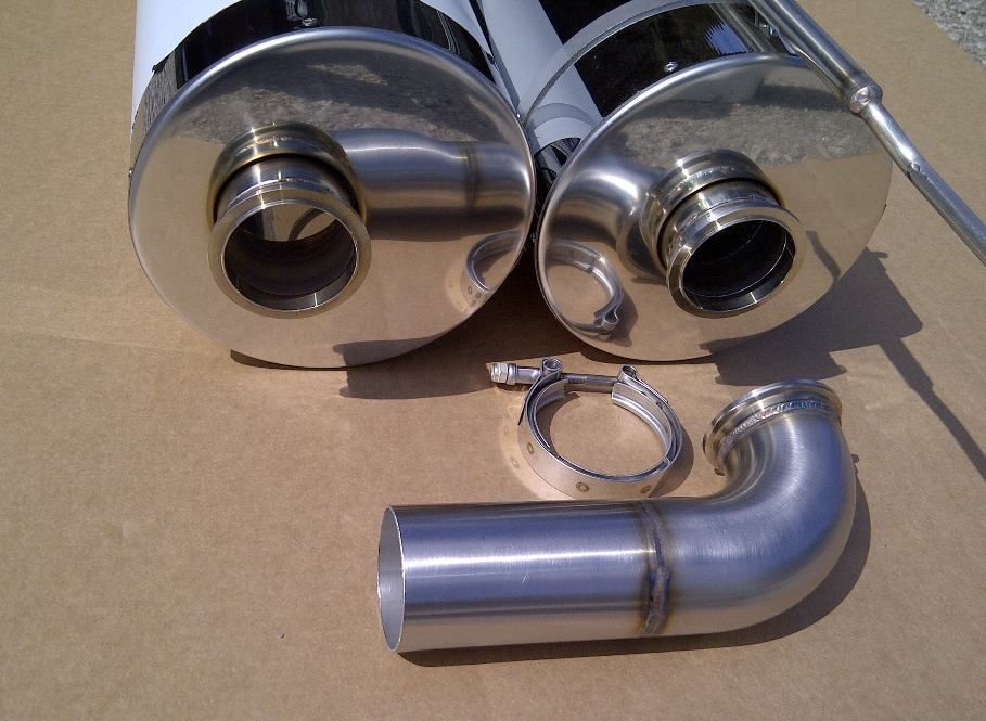

I tried installing a clam hinge along with a 2bular header and decat. My 8" 2bular exhaust is crashing into the rear panel delete and the tip crashes into clam when it tilts. Do I need to go with a BOE exhaust?
BOE will work..I have the Tubular 8" but mine was made with a removable/adjustable tip. I actually have a BOE tip now that does not have to be removed for a tilt but have the option to go back to my original tip as well.
-Loosen the exhaust mounting and try to rotate/cheat it forward.
-If the above doesn't work, add new mounting holes in the diffuser that will provide for the rear panel to be mounted further back on the diffuser. You can obviously perfect the mounting if you use this strategy.
-Regarding the tips, some of the bling tips just stick out too far. Only so much movement can be dialed into the hinge mechanism. LotusF1 was smart to have his tip removable. Perhaps modifying the muffler in such a way would be a good plan of attack.
-Swap to one of our exhausts
Yes, you need to cut 2" off the inlet end of the silencer to clear the stock cat - hence the popular 8x22 2bular install with through-diffuser oval tip - (or twin-tip)!
