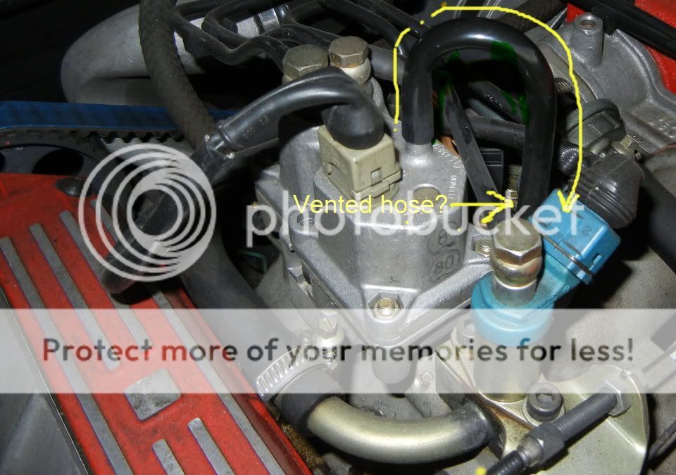

My 88 Esprit (Bosch CIS) is up for a 1 year CA smog (Test Only). It passed fine on purchase back in July 2011. However, after about 10K miles of driving since then, the idle is still sporadic when hot (drops to 600 RPM and slowly goes back to around 850RPM). Cold starts appear fine - 1800 RPM and drops to 1200 RPM before finally reaching 850RPM @ 80C
MRDANGERUS gave me some tips to check vacuum lines and other items, but nothing stood out. At least, until now. Below is a picture of what I believe to the CPR (Control Pressure Regulator aka WUR Warm Up Regulator). What surprised me is there is a 1/4" diameter hose that appears to be a VENT hose (the U-shaped black hose). There is no obvious connection for this hose near by. Am I missing a connection? I don't recall CPR having a vent?
1,505 Posts
The control pressure regulators on our cars are built with full-load enrichment and altitude compensation. That hose connects to a vacuum nipple. I believe at high altitude with reduced atmospheric pressure it aids in the operation of the aneroic capsule expanding and exerting an additional closing force on the control pressure valve, raising the control pressure and compensating the mixture strength for altitude.
Super Moderator
4,119 Posts
Discussion Starter · #4 ·
It is normal. It is just a vent. Mine has the same thing. Lotus WUR is equipped with barometric diaphragm.
Thanks for the confirmation. Never ceases to amaze me what I learn decades later with CIS.
