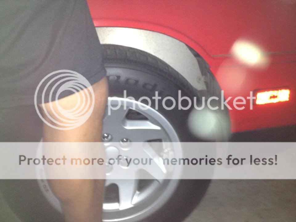

Filling up the Esprit wearing shorts (just got back from the gym) and I notice immediately the flood of hot air washing over my leg. I know there's a prominent heat shield on rear driver side wheel well, but was surprise how HOT it was. Never noticed it when wearing pants.
It was a 10-12 mile drive home from work (70% surface streets,30% freeway) and no apparent mechanical issues - just normally hot?
Maybe it's the cold California temp (low 60s) that made it obvious. But for a second, I thought something was on fire :panic:
