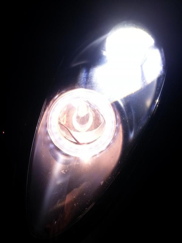

They ended up fitting and so I took the time to test them out on my housings (I have an 05 Elise)
They looked pretty good after a test fit (no permanent or semi permanent gluing done yet)
This picture shows a orangish hue because the high beam was on in this test picture and the high beam is still halogen (even it it is a 6000k bulb, we all know halogens and color temps are controversial)
