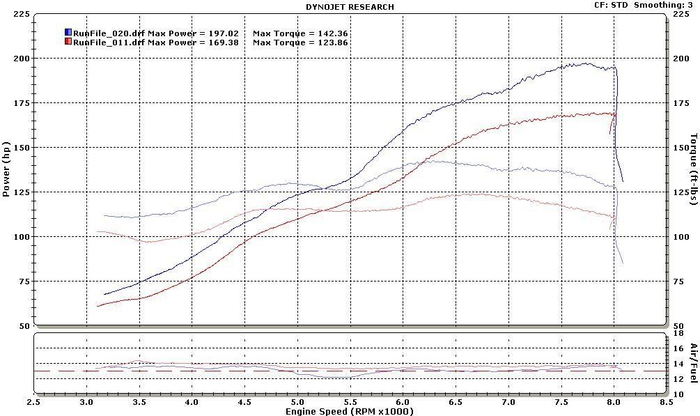

Bone stock pull versus stage 1 mods :evil:
