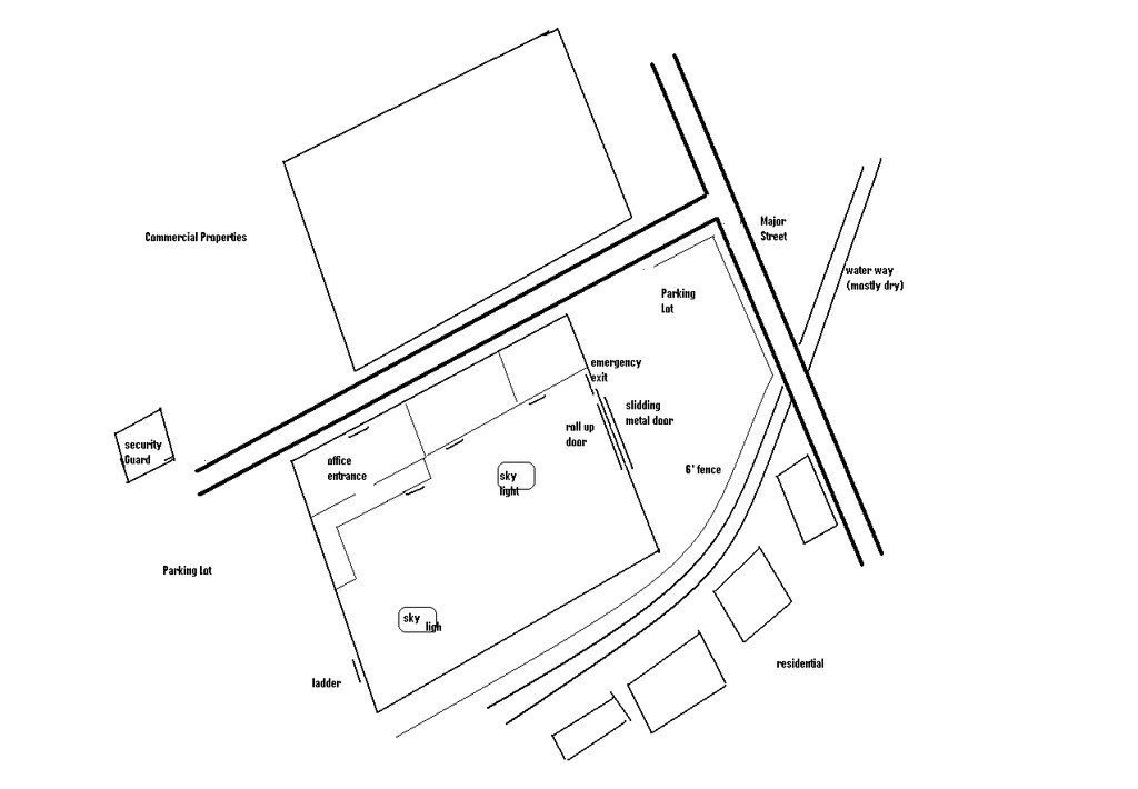

I have a warehouse that I am trying to secure. I'll try to explain what my warehouse looks. The outside: Commercial area, security guard on duty 24/7, The warehouse has one sliding door with a roll up door behind it. It also has an emergency exit door located next to the sliding door. Those are the main entrance points of the warehouse. On the opposite side of the warehouse entrance is a ladder to the roof. There are also two skylights.
So far, I have installed an alarm system with motion sensors pointed at the skylights and the doors. I also have 3 hinges welded onto the wall to secure the sliding door. I put 2 locks on the bottom of the roll up door and I have a lock and a steel bar on the emergency exit door.
My problem: I had a break in a month ago. Nothing was stolen. The police believed that the point of entry was the sliding door/roll up door because the locked hinge was torn off. However, it became clear to me that the point of entry was actually the skylight. The security guard saw no cars parked on the street. I am assuming then that what they had done was park there vehicle in the residential area and walked across the water way, up the ladder and in through the sky light. They then rolled up the roll up door and used the truck or forklift to break the locked hinge on the sliding door.
I have since reinforced the sliding door with two more locks since the time of the break in and I also have a sensor on the roll up door as well as motion sensors focused on the sky lights.
Now, since I am trying to cut costs, I am required to be in several places at once during operating hours. I am working on setting up an effective and practical inventory system but as of now, I do not have an accurate and cost effective means of knowing what I have and where it is at all times. Because of this problem, I can never leave the warehouse alone when installers/workers are present.
I want to be able to see who and what are going in and out of my warehouse at all times. I have read that there are motion sensor systems which send an alert to the user when they are activated. This would be ideal.
A problem I have with the sliding door is that the hinges are very malleable. In fact, the other day, one of the hinges FELL OFF as I was closing the warehouse. How can I effectively secure this sliding door?
Next, the sky lights. Previously, the hatch to open the sky lights was on the roof. Now the hatch is secured to the inside of the ceiling. The sky lights, however, look like they can be broken into, regardless of the hatch. Is there a way to prevent any possible entry via skylights?
The current fence that I have around my business only stretches along the back side of the business adjacent to the water way and partially along the front and main street. Needless to say, I need an upgrade. I need to be able to secure my parking lot from trespassers. Should I look into barbed wire or some other means of deterance?
Finally, for those that are familiar with securing a business, how much will this run me? I already mentioned that I am in the process of cutting costs but certain measures (such as security) are worth spending some attention to.

Are the sky lights necessary? Could they be closed over and install lighting in the warehouse instead?

The property is being leased so I do not wish to make any permanent adjustments. If it were up to me sheets of metal would be welded over and under the skylights.
Regarding the surveillance system, I am not sure how many cameras I need. Can anyone give me a recommendation of a system with cameras that would work best for my situation?
Ideally, the surveillance system will be digital and able to be accessed from the internet.

Can you detach the ladder and store it inside?

That is a good idea. The only problem is that the ladder is probably 50' tall and space is a premium in my warehouse. The other obvious problem is that I will have to get the landlords go ahead. I will look into it, though.

If it's a 50-foot ladder to the roof, how would they lower themselves 50 feet once opening the skylight?

There is a rack that is located a couple feet to the side of the rear sky light.
Fire code/fire marshall will probably insist that the ladder stay in place.
Yes...this is correct. I can't remove the ladder.
It seems that a full on gate/barbed wire fence surrounding my business will cost 6-7k and that is way more than I am willing to spend on a gate. What I'm thinking about doing is raising the fence on the backside of the warehouse and lacing it with barbed wire. This will stop anyone from crossing the waterway. Then the only way to get in and move stuff is on the side with the security guard present 24/7.

Here's what I would do to secure the warehouse.
First forget the outside fence. Those are too easy to cut thru with a small pair of wire cutters. Anything short of concertina razor wire is no real obstacle.
The ladder to the roof can be secured by having a three sided masonry structure built in front of it with a steel security door. The top of the masonry would have concertina razor wire on it. This enclosure could also be alarmed. The local fire dept. and police would probably need the keys.
Steel bars under the skylights either welded or hinged with locks. The building owner may like the idea for security for his building. Your insurance company may lower your rates if you add more security for the building.
The sliding door and roll up door can be secured at night/weekends/holidays etc. by parking your forklift with the forks used to make opening the door from the outside nearly impossible. The emergency door must be secure and entry with a key from the outside possible.
