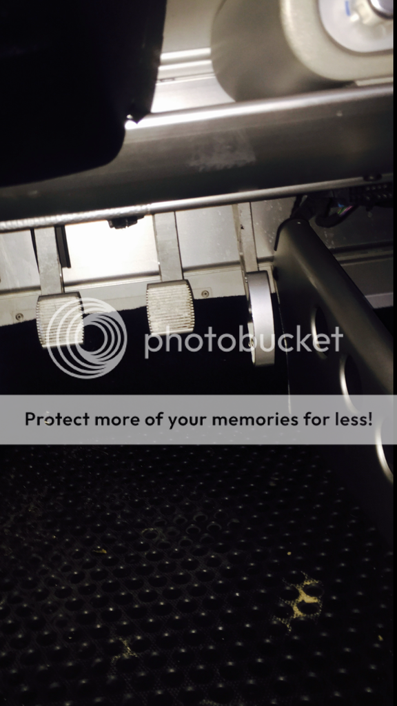

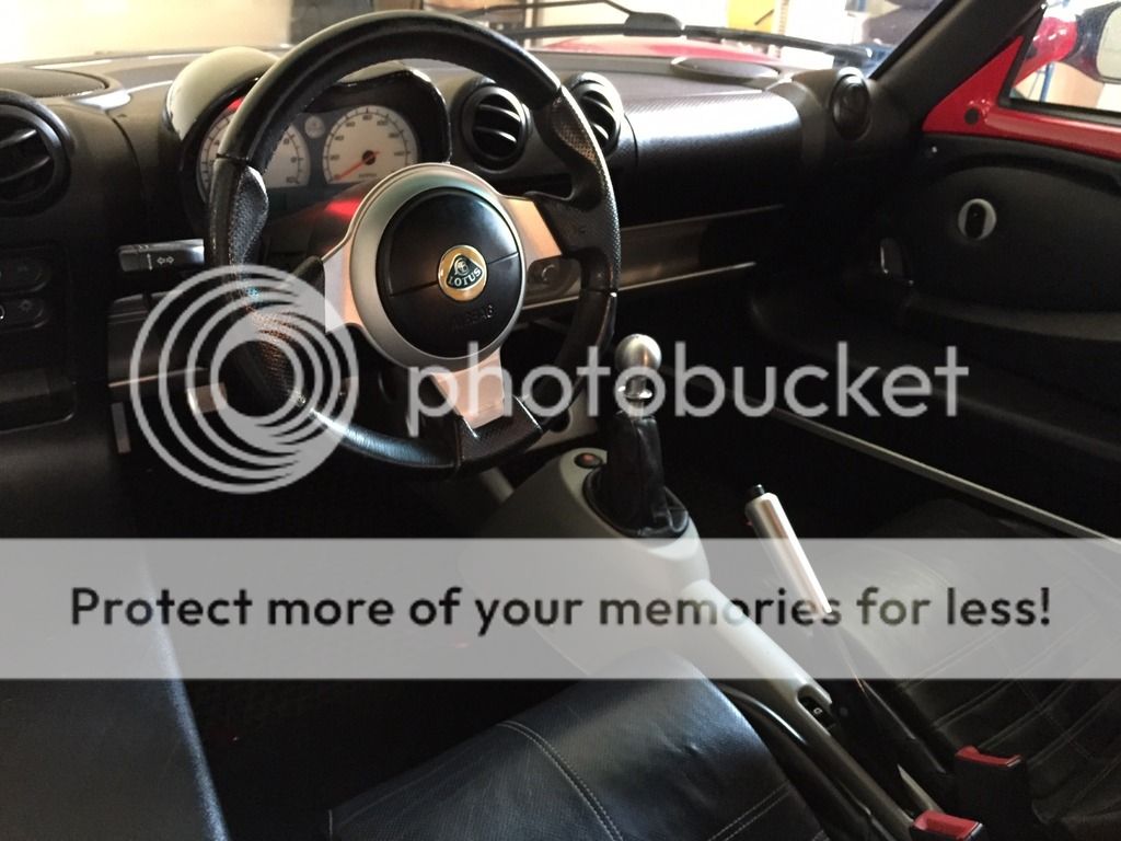

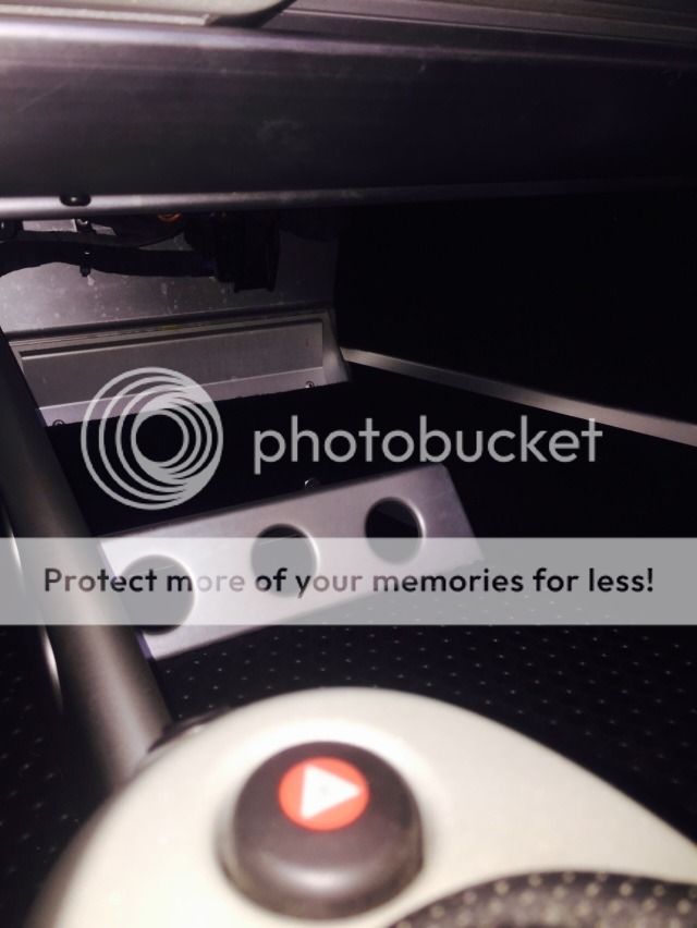

Oh, and did the side carpets as the sills were getting dinged up for various reasons. This keeps them covered and protected, but reversable.
Pics:
  • Like
Reactions: shay2nak
8,534 Posts
Discussion Starter · #4 ·
Carpet with the binding on

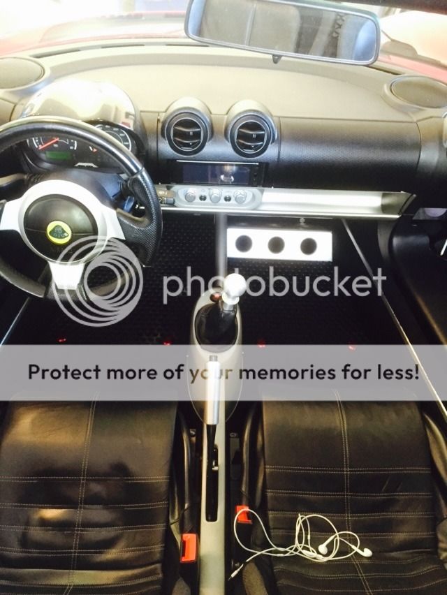

SwingLo - great thread! (resurrect!)
I've been thinking about doing this for the floor and bottom ribbed sections but leaving the sides exposed. Too much going on with all my aluminum and carbon... I might do the sides but I'm still on the fence...
Any more pictures of your interior? Specifically from farther out...
BTW in post #3 it looks like you're missing an under steering column cover screw...

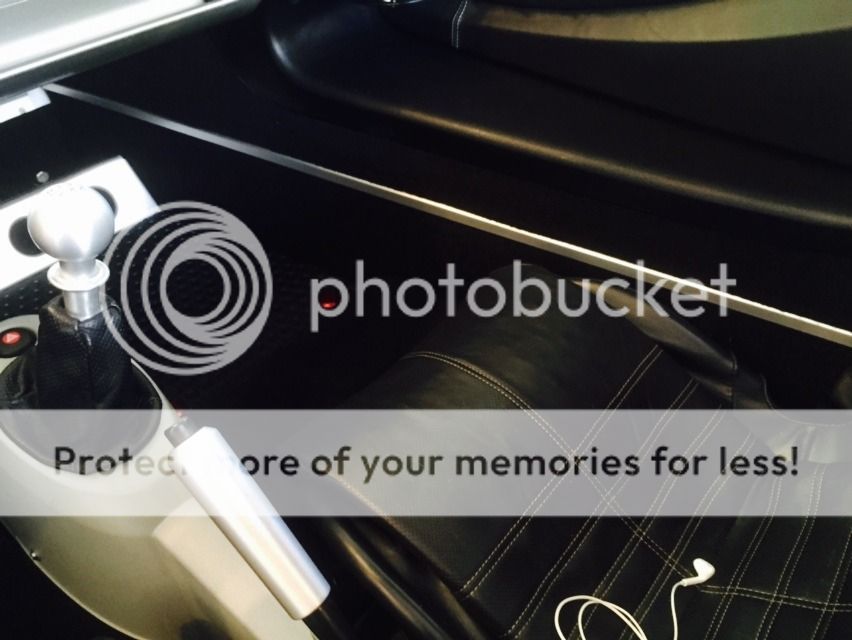

129 Posts
I put carpet in my elise this winter. I love the way it looks. Took the time to put in some sound deadening while i was at it.
I would recommend doing the sides as well, it really adds to the feel of the car. It makes it not feel as much like a go kart.
Here are some pics of mine. I wanted to keep the rubber mats and the buttons for easy cleaning and a little differentiation of textures. Pic quality kind of sucks.
