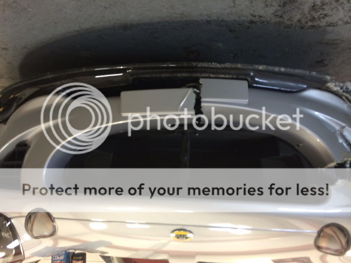

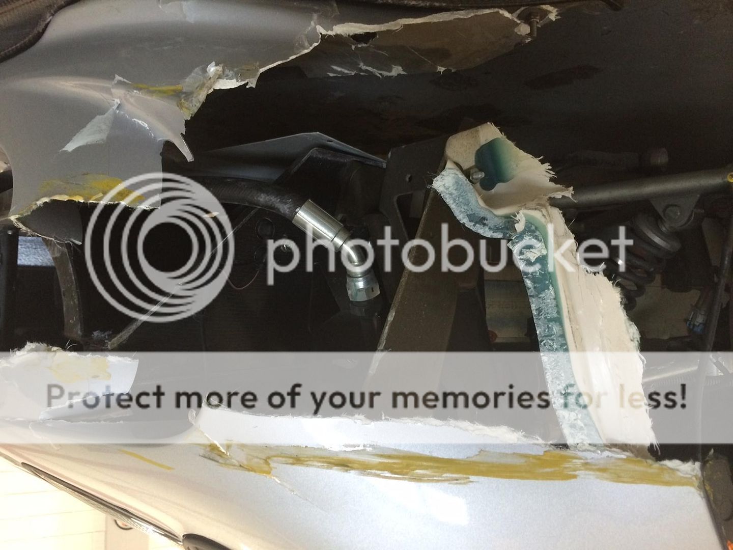

Crash structure is intact , the front clam… not so much….
The headlight is gone
The radiator support structure has a couple of cracks….

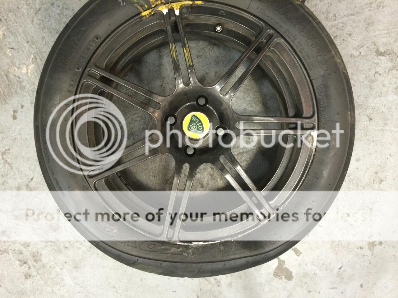

The front wheel that took most of the impact.
The radiator support separated from the clam and cracked pretty bad.

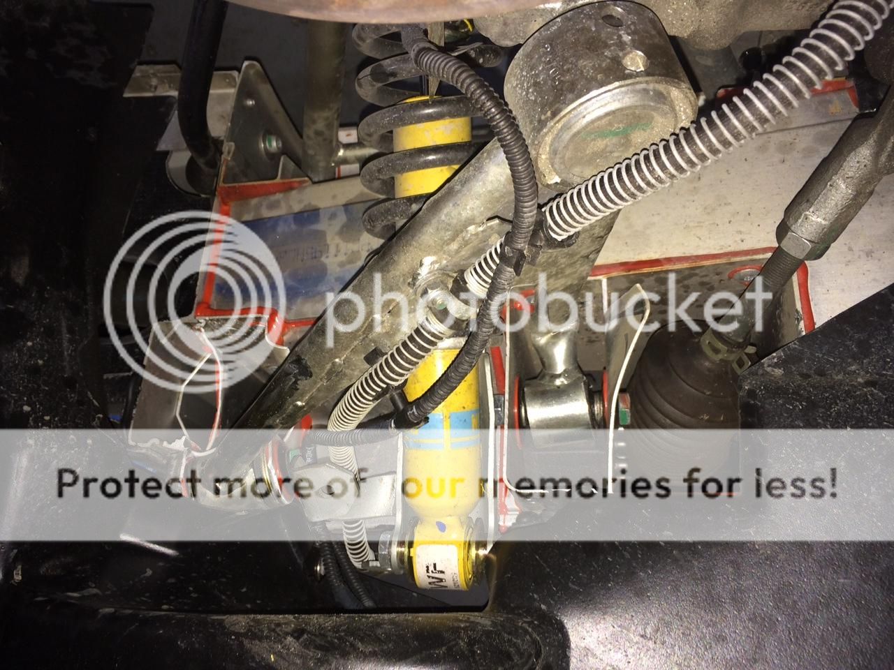

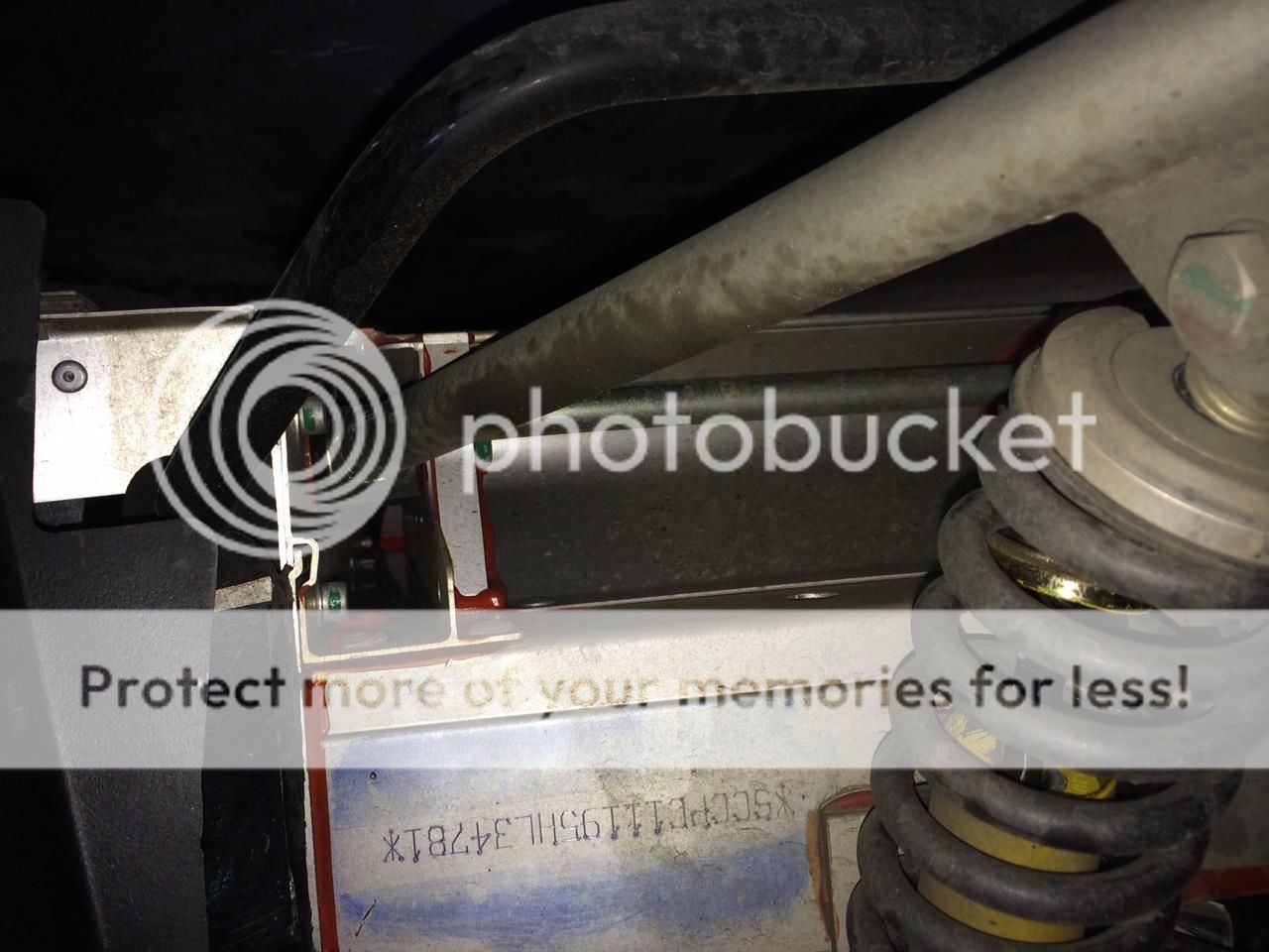

Now the ugly….

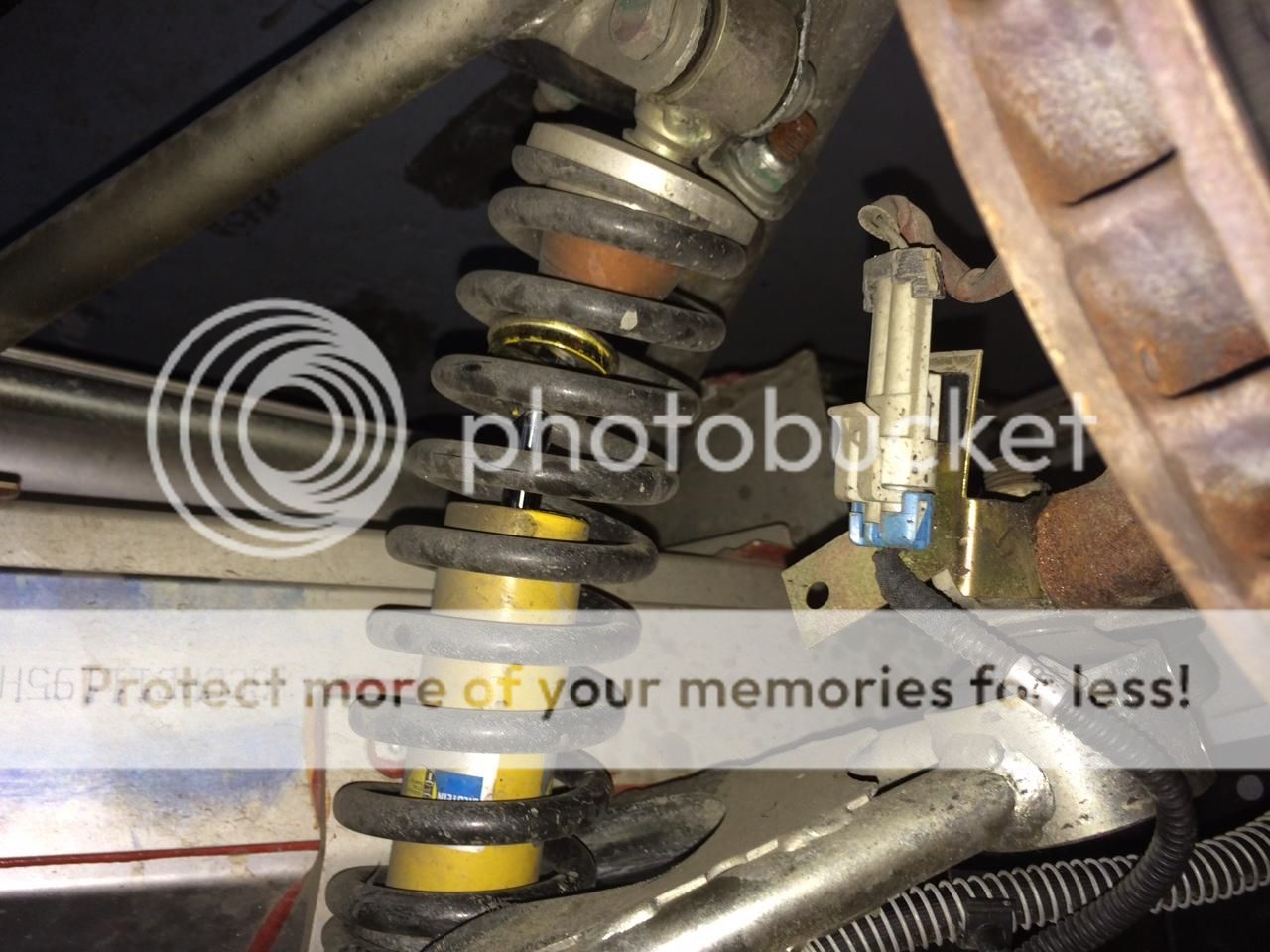

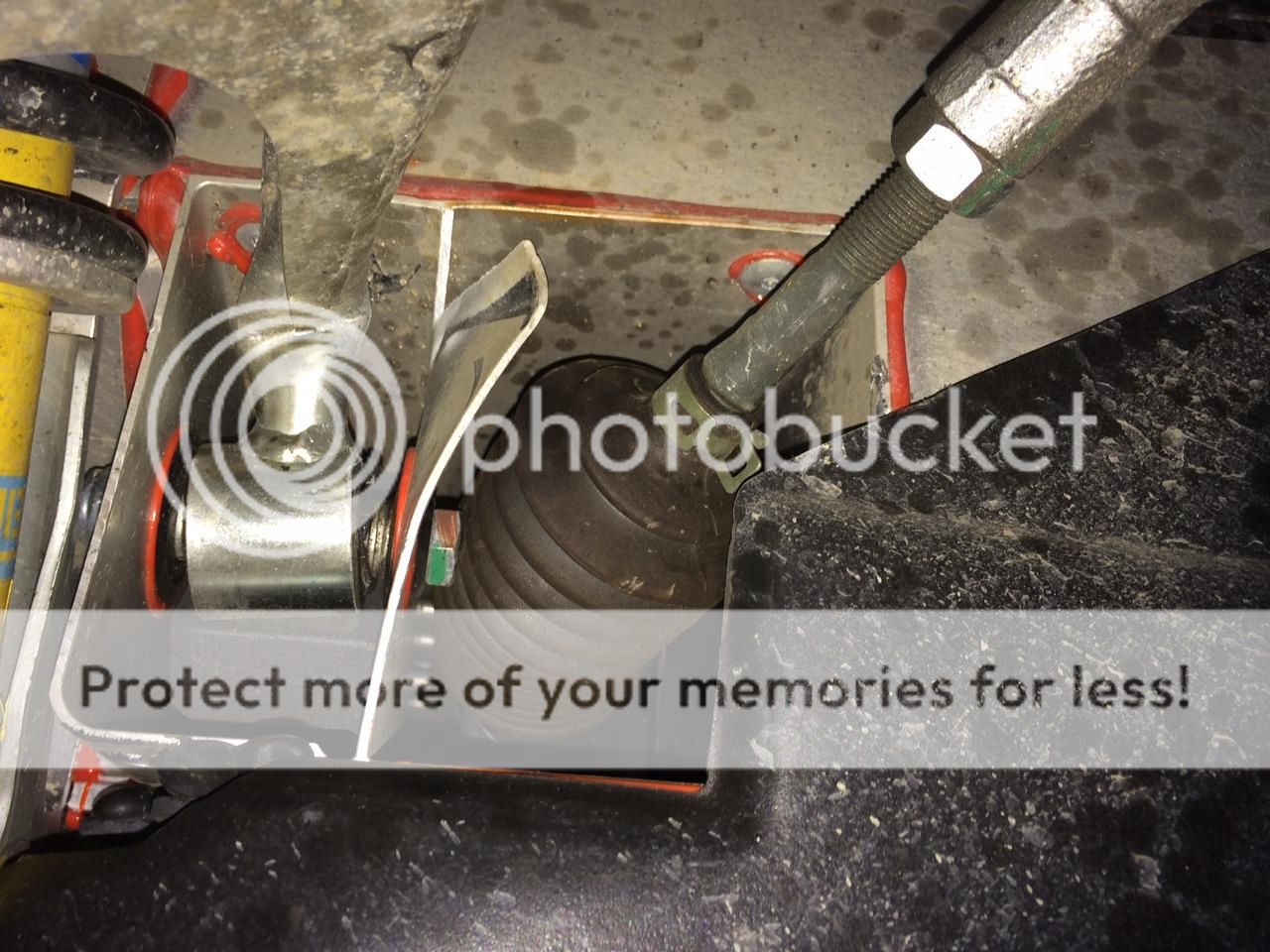

Front strut…. Broken
Front-rear upper control arm mount…
Front lower…seems fine.

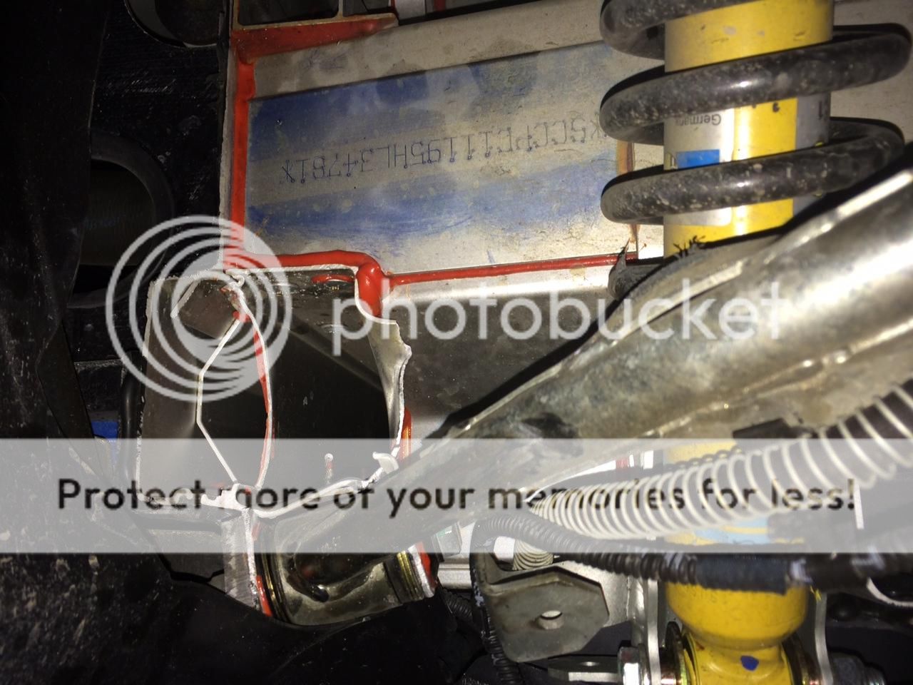

Now the real ugly.
Front upper control arm mount…completely ripped off the frame.

That damage is not all that bad... true, the structure is not repairable by the automotive industry, because they don't have the knowledge, but this is completely repairable by someone knowledgeable in repairing aircraft. That tub is also made from a 6000 series aluminum...that is also a weldable grade, but the welds cannot be next to the bonding. Go look for an aircraft mechanic or a race car mechanic...if you really want to repair the car.
