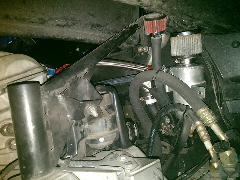

here is a diy setup, I actually revised my catch can setup as of yesterday to be entirely open system, remove the saikou cans, clear out some room in the engine bay so I am just running one catch can that is taking oil from two crank case locations instead of 3 cans from 3 locations
also for what its worth I have a set of the saikou michi cans I was using I just listed
moroso can has two bungs welded, so the crank case location on the upper back of engine is going to the can and then one of the crank case locations where a can is normally installed is routed to the can with a hose
may mess with this some more later

I cant work that out, but mind telling us what the problem was with your previous set-up that lead to this solution?
The previous setup with the saikou michi cans was closed loop, meaning that blow by can still get into the intake.
In a normal NA setup this is not a problem as the oil gets burnt up and expelled out the exhaust. In an FI setup that oil depending on where the blow by enters the intake passes through the intercooler and can coat it with oil which theoretically reduces cooler performance to some degree.
I went ahead and changed the setup I have to be completely open loop and blocked off the inlets where you would connect the breather to the intake. The part that would go to the intake is now an air filter instead of a hose to the intake.
