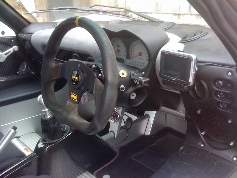

Mine is a 2006 Eu model Exige... All of the above + The dash is different and covered in ALCANTARA® as well as the steering wheel, the speakers are in side panels over the frame rail...
There is still a charcoal canister, but it is a different set up than the FED models (and better in my opinion as it take up less space is round and is tucked away nicer. No need to move it for a supercharger kit. :D
