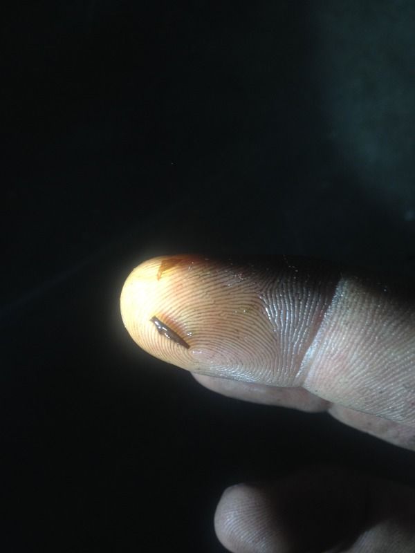

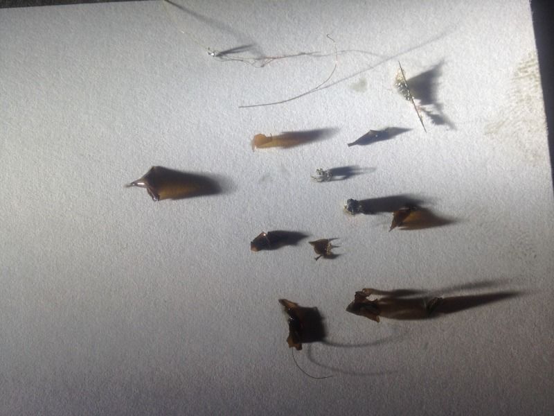

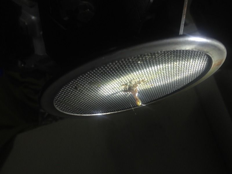

So the motor is out and I pulled the pan off today, and here is what I found on the pickup. It looks and feels like some sort of film... slightly transparent, and brown in color. Along with some slivers of what looks like copper, and aluminum.

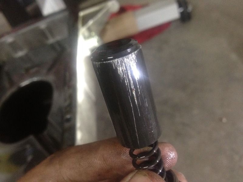

I pulled the oil pressure relief valve out found some pretty serious gouges on the piston.

Did you replace th eoil coolers from the "accident" with the previous engine?
If the previous engine sent any metal particles into the oil coolers, they are very hard, if not impossible to clean out, and are technically supposed to be replaced.
No idea what those things are in your oil... Might be Loctite sealant?

The turbo also could have let go due to a blockage in the return line causing oil to blow out the seals. That blockage might have been that same goo.
I still don't have any idea what those copper strands could be.
The brown film does look like Loctite 518.

Im almost certain the issue with my motor rebuild was something caught in the oil pressure relief valve. looking at the gouge marks on the piston and I also just found some interesting wear marks on the inside of the piston and outside of the spring which I think points to it getting stuck open.
now heres the question... should i pull this all apart and replace the rings/bearings etc, or should I do like the old thread I found and just rebuild the oil pump?

If your oil filter has no metal and you are positive the metal is from the relief valve and if your bearings look good, then just replace the front cover fron your old motor and call it a day.

The copper and aluminum is coming from somewhere, most likely a spun bearing which is why you do not have oil pressure. The pressure valve is messed up from the contamination and could be sticking because of that also causing the oil pressure to be low. I would at the very least start pulling bearing caps but I think a full tear-down will be necessary because of the low oil pressure and all of the contamination in the oil. Once you get it apart it will be easier to figure the cause. It is either an assembly issue or a contamination issue. Cut the oil filter open. No matter how good any mechanic is, it is always possible he made a mistake or maybe it was a defective part. A full autopsy may reveal the truth. Depending on why and how the original motor failed you probably should have replaced the oil coolers or at least had them properly flushed. Read the plugs. Are they black from oil or too much fuel? I do not have a good answer as to why your cats failed unless you are pushing oil past the rings and fouled the cats. Is your exhaust pipe oily?

Have you checked out both your turbos?
Based on everything you've detailed, the evidence also suggests the possibility of a blown bearing / seal on one of the turbos.
The debris is consistent with the turbo shaft journal bearing material (copper, or actually bronze), and the other stuff may be chunks of the plastic / phenolic seal / housing ???
I don't know of any other place (other than maybe the small end rod bearings?) in the engine / mechanicals where you will find copper / bronze. The main engine bearings and big end rod bearings have copper in them but not in raw form like that, only in particle form impregnated into the base material --- so, when they shred, you don't see copper shavings like you have there.
Since the oil drain line from the turbo dumps directly into the sump, any debris from a damaged turbo bearing is going to be sucked up by the strainer (if it's small enough), immediately into the oil pump / relief plunger mechanism. And, once it's damaged, you will get a pressure loss.
Also, when oil can get past the shaft from a blown seal / bearing in the turbo cartridge, it can then get sucked into the intake side of the compressor or blown into the exhaust side turbine ---- either way, you will end up burning oil out the tail pipe.
