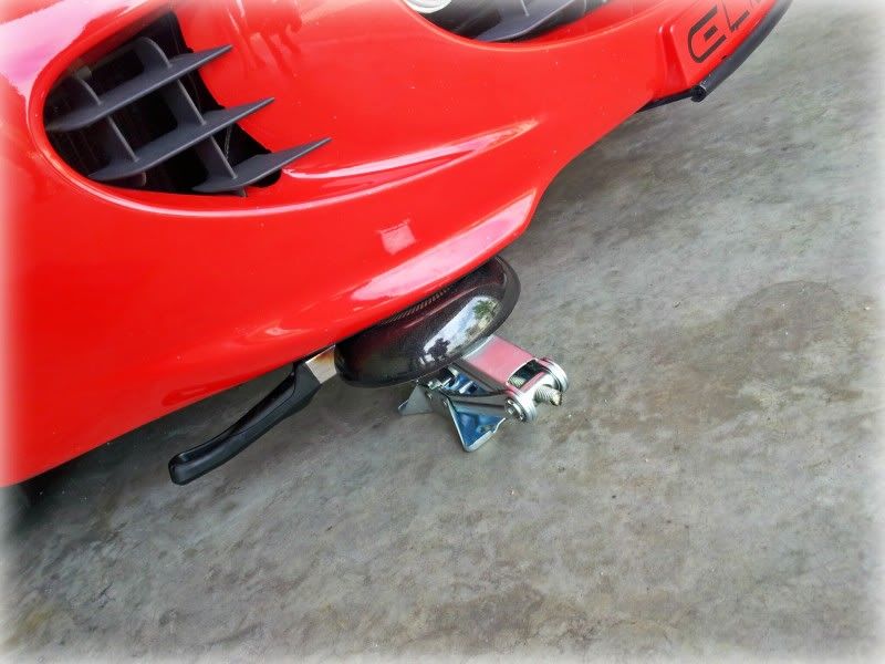

I used a very technical method for distributing the "up-force" as evenly as possible whilst installing these over the holiday weekend: That is right. Snap On Frying Pan. If I break it, I get a new one.... for life.
