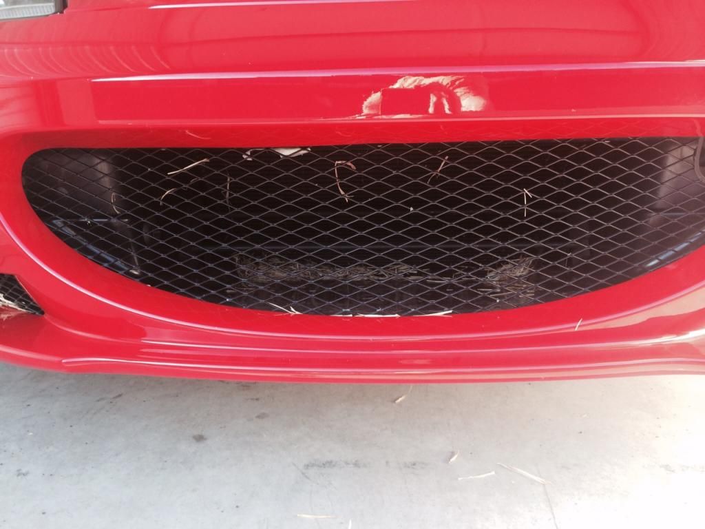

So was was driving along today when there was suddenly a lot of Hay on the road - I tried to get out of it so that none of it would damage my car and fortunately none did - However, there is quite a bit stuck in the back of my cars intercooler.
My question for you all is how hard is it to access this area - is it something I can do myself? - I assume is is just removing the front aluminum panel.

Actually a radiator. The Evora S does not have an IC. Just drop the belly tray and hose out.
1,404 Posts
Can't remove the grill so you'll have to remove the undertray. Have you tried a vacuum cleaner?

I'd start by using an air compressor from the top to blow as much down low as possible. Maybe while a second person has vacuum below? Try that before the take apart.

What brg said, but stick a piece of tubing on the air compressor and slide it through the mesh so you can loosen up any stuck pieces of hay better.

Leaf blower from the top?

I have a pair if endoscopic forceps for issues like this... the one that looks like a long wire with a small tweezers at the end of it...
