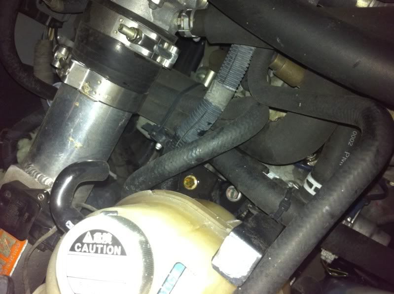

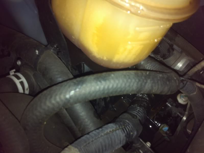

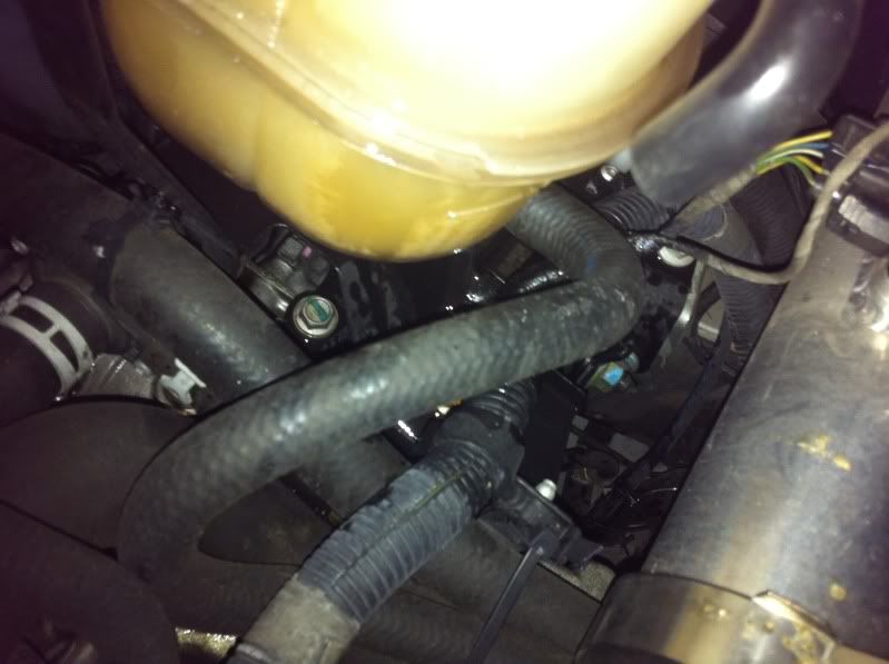

Hey guys, I'm experiencing a problem with my car. As title states, my heater is blowing cold air at idle and warm during throttle. Yes, I used google and came to the conclusion that my coolant maybe low? Immediately after reading about it, I popped open the trunk and saw my reservoir cracked and leaking some pink stuff.
Could this be the reason why my air conditioning is acting up? How much for a new replacement and link if possible? I'm not exactly a DIY guy, but I know how to turn a couple of bolts. How hard is it to change this out and any tips? If this isn't the problem, what is it then? Help me out fellas, thanks! Here are some pictures of the reservoir.

Yes, this usually means you are low on coolant. There isn't enough coolant to circulate in the heater core when you are at idle so the air coming out of the vents will not be warm.
Replace the reservoir. Make sure the coolant is fully bled. If there are any air pockets in the cooling system, you could possibly still have the same problem as well as the car possibly overheating. Bleeding the cooling system on these cars can be somewhat of a pain, so if you don't feel comfortable doing it, I'd recommend taking it somewhere to get it done.

You can also try parts.olathetoyota.com.
Brand new, these tanks aren't cheap ($150+). The problem with the OEM tanks is that they are prone to dry rot and cracking from UV light over time. Mine developed a hairline fracture after just 9K miles. For peace of mind and some extra cash, you could go with an aluminum tank like Radium or similar.
