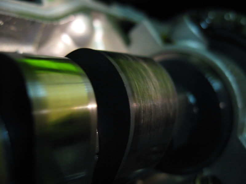

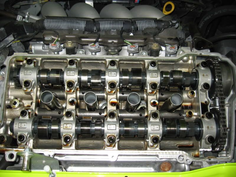

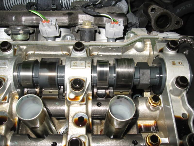

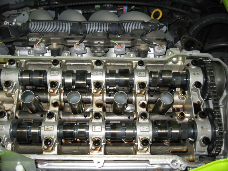

I reluctantly decided to pull the valve cover after hearing about some of the horror stories with this stupid cam lobe issue. All the lobes looked mint except for one. The one on the far right on the intake side had some very minor scraping on it... so minor that I could barely feel them when i ran my finger over the lobe. The 2nd cam still seems strong when i hit "lift" and I haven't had any check engine lights. Do I have anything to worry about here?
(sorry for the pics, there wasn't a whole lot of light in my garage)

If you "scratch" across it with your fingernail, can you feel that it is scored?

No 1 is the closest to the passenger side of the vehicle and the timing chain. The lobe with the scratches is the high lift intake cam lobe of no. 1 cylinder. How many miles? There are links to other pictures on this site. Review them. Mine pictures are under "camshaft check pictures"

You should be able to feel a groove in the middle or a ridge on the outer ends....that is what mine felt like...I dont know...if you dont feel a ridge...it may be ok...but it does look bad.

which one is number 1?
Easy way to tell with the valve cover off is: You see in the pic where it says 'I1'? That means that it's intake-side, cylinder one.

It does not look very bad, and it does not seem to have any end ridges.

My suggestion would be to keep an eye on that #1 lobe and inspect it at least once a year. I have to agree with the others that this does not look good, but you have a long way to go before that lobe is worn far enough to set codes and/or break a rocker arm. How many miles are on this engine? I have a spare engine with only 1,100 miles on it that has this same appearance on one of the intake cam lobes as yours--looks like it is just starting to go bad.
I can say that the replacement cam in the engine in my car right now has just over 1,000 miles and is showing no signs of any abnormal wear (I just inspected it seeing as my warranty is expiring soon) so I am hoping the new cams don't have this problem too. Good luck, and if you continue to run that cam, keep us updated on the wear.

I really don't think its as bad as everyone is making it out to be. The pictures actually make it look worse than it is.
