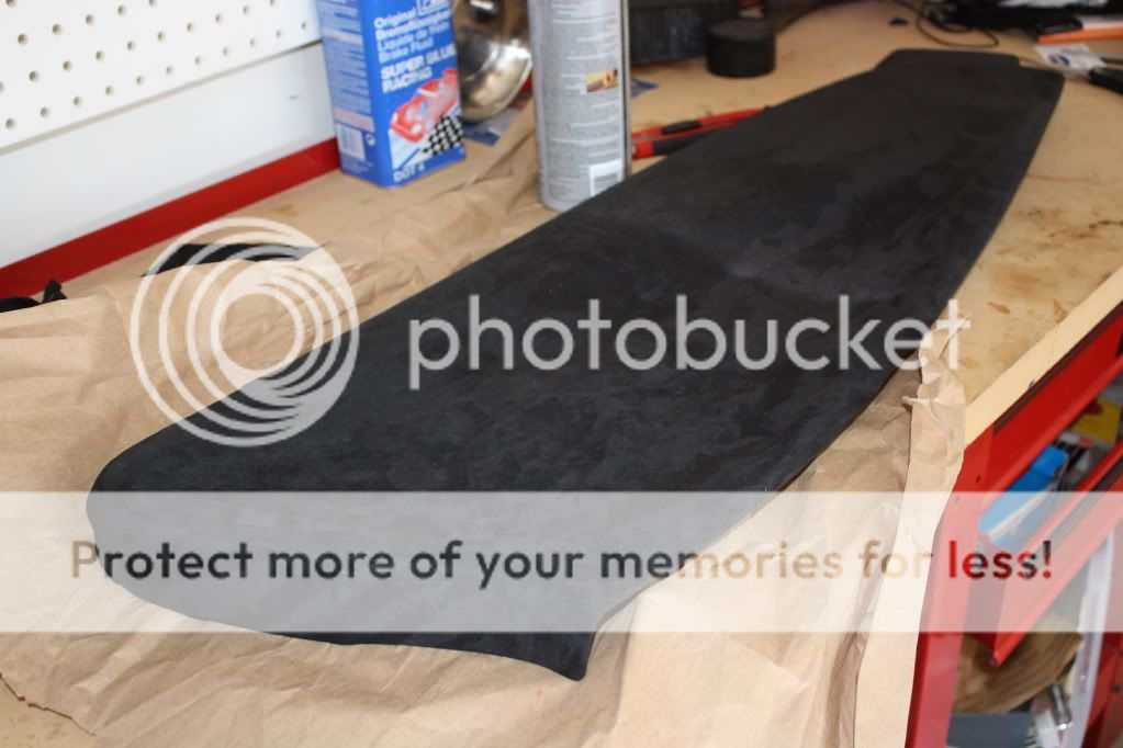

As you can see, they're pretty awful. So I went out, picked up some microsuede fabric from Jo-Ann Fabrics (try doing that on Labor Day sometime...women extravaganza :huh:); 1.22 yards for $10.83 (it was on sale - w00t!). I had some 3M spray glue from a home renovation a few months back, so decided to use that. I think it's around $5 / can. Can't remember though exactly.
First, I removed both door panels, as well as the tear drop. Door panels are held on by screws, you just twist the caps off first, then use a Philips head screwdriver. There are 4 of those, then there is a plastic "christmas tree" screw at the front-bottom corner. You move the panel towards the rear and it unhooks from a final retainer and velcro.

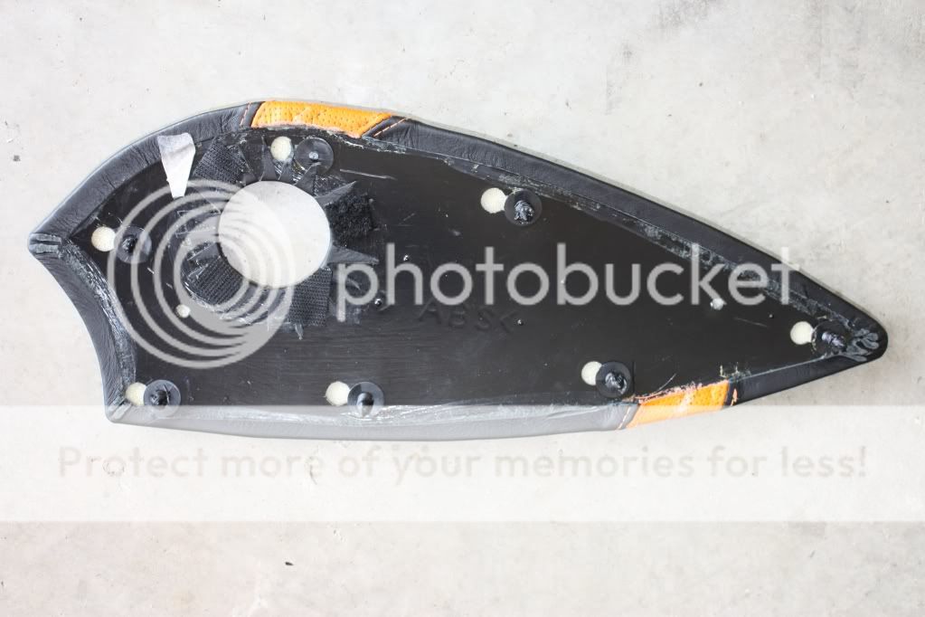

Next, I pulled the "christmas tree" screws off the back of the panel to separate the tear drop. This takes alot of effort as they do not want to come out. I later learned you can just slide the tear drop and it removes it from a latch system.
It took ALOT of courage to take the plunge, but I started cutting the suede material to shape, then matched it against the panel to make sure it would fit. Make sure you leave plenty of room on all sides, as you want to wrap it behind. I would say 2"-3" is good. Leave more room at the bottom front corner. Next I sprayed about 10-12" of the door panel :)panic:) with the 3M glue, then started smoothing the material onto the door. Make sure you only do small sections at a time, as you need to re-align it as necessary. I would assume if you've put on stripes before it is similar.
I don't have pictures of this process because my hands were filthy from touchy the glue, then the suede. If you accidentally get glue onto the suede, just use some Goo Gone and it wipes off easily. The most difficult portion is the front-bottom corner, as it is a sharp corner and you can tell even Lotus has trouble with this as they had to use a new piece of material to handle it. Final product below:
Cut the screw holes onto the suede material as well as cut out the center part (so you can smooth the material into the grooves), snap the tear drop back in place and you're ready to reassemble onto the car.
I think it makes a HUGE difference, and is much better than paying $250+shipping from Lotus (if they even carry it any longer) or $150-$200 at a local upholstery shop. What I should have done, is started with the passenger side first, then figured everything out and made the "better" side the driver's side. Unless you have lots of passengers, then you can hide your mistakes ;) I wouldn't say it gets any faster, but it definitely is a *little* easier once you do one side and know how to lay everything out.

Looks wonderful.
I have some experience wrapping a speaker baffle with microsuede. Two things I learned:
1. Where the panel you are wrapping curves, cut slits in the material that wraps around the back side of the panels. This allows you to wrap around curves and stretch the material properly so that everything lies flat on the front.
2. After you spray on the adhesive, wait a few minutes for it to become tacky.

Good call - esp on #2, as I didn't learn that until halfway through and had glue that wasn't "sticky" onto the door panel yet all over my hands.
