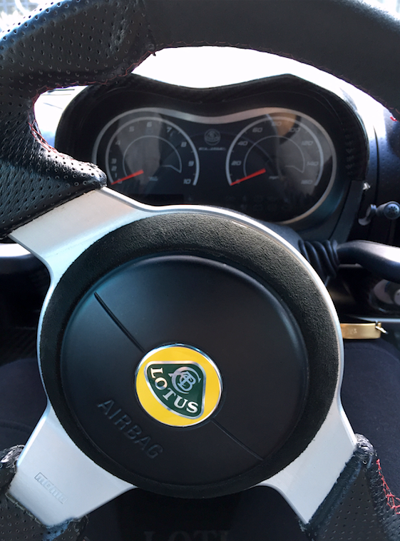

Nice pic Terry!! It certainly does look (better than) OEM!
This looks fantastic! What did you use to secure the gauge face to the cluster? The stock cluster uses that white plastic surround to hold the face down which I don't imagine can be used with the clear plexiglass cover.
I use the same white frame that used to be in there. One thing i did different is that i spray paint the white frame black. it looks so much better Everything fits perfect, the trick is the trim down the needle stem just perfect so it doesn't touch the glass. And if it really does touch the glass, you can always throw a layer of heat glue to create even more space/clearance between the glass and needles.
