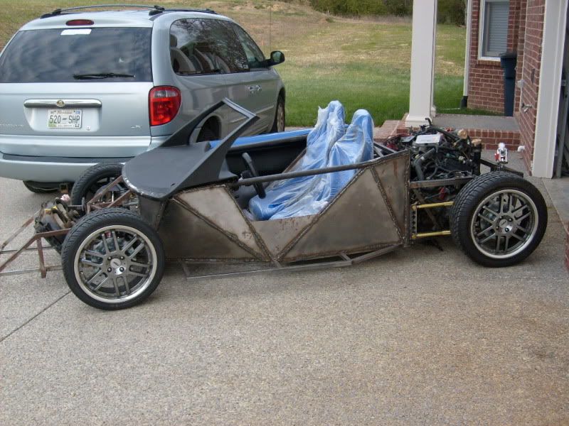

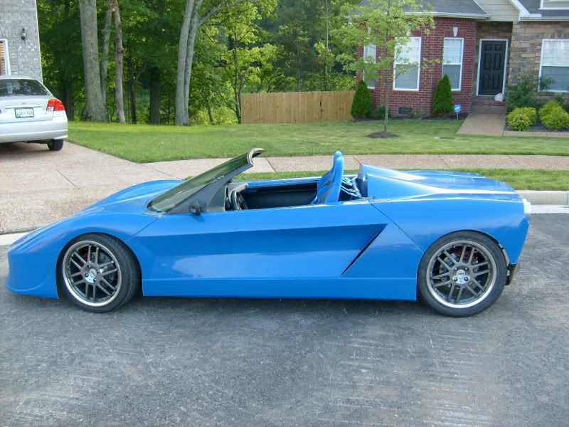

This is my La Bala. It weighs 1600lbs. I'm using a 145hp Toyota 4AGZE at the moment but the Ecotec is looking real appealing. Home built, from the ground up. The body and chassis plans are by Grabercars (www.grabercars.com) I just got it registered this month and have been driving it around. It still needs a paint job (the blue is the gelcoat on the fiberglass) and a few other minor things...headlights and such >< I thought this would be a good section to post as the car has many traits of the Lotus focusing more on lightness than giant HP numbers. It's been 2 years in the making, mainly so long because I've never done anything like this before, this was the first La Bala built off of the chassis drawings, the first prototype is very different, and I've been on a strict budget. All in all, about $13,000 invested. I started the build In AZ and ended up in TN :D
I hope to get the car to 200hp and cleaned-up to show car quality as my next goals with it.

I started the project with only basic car knowledge. I could do engine work, but I'd never welded anything except with a stick welder in my life. So, lot's of internet lookup and asking questions, and I finished it. I think they know me at the tool shop now I've been there so much.
The handling is pretty good right now, maybe not quite as smooth as the Lotus, but I have some dialing in to do. For one, I need to add a sway bar to the front suspension. I also need to adjust the dampening and rebound. I used R6 motorcycle shocks which are very adjustable.
I'll post some more pics in the near future.

Really though, the car would be an almost total loss in a crash, but the cabin is actually pretty well protected...assuming I don't get nailed in the side by an SUV. The 1.5" DOM tubing is pretty thick and surrounds the cabin. The metal would bend and be ruined, but I think the cabin would remain intact with the remaining portion hopefully crumpling to absorb the initial impact.
Well, the goal is to never find out. :wave:
