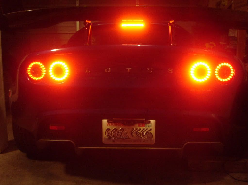

Update:
Just got a replacement LED tail light from my local Lotus dealer and did same thing.
I took my voltage meter out and measured my brake wire and reads 0 volt but as soon as I turn my ignition on it reads about 5 volts. :confused::confused:
I know now that it's not the tail light. I wonder what it could be?? My other (older) inner LED tail light works perfect.
So for now I have to have my lights like these:
