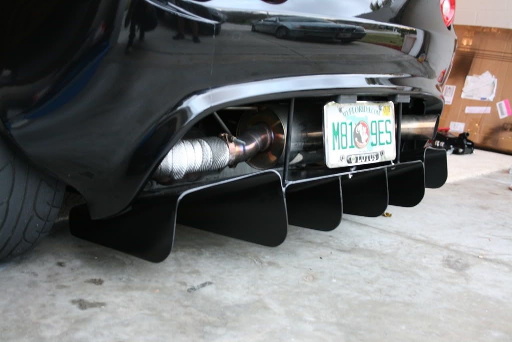

I cut my shield off as well. I also double wrapped mine with 2 layers just to be sure to keep the heat off of that corner of the car. You don't need to use sealant. Over time it will turn grey and then gradually whiten... When it get's to a shade you don't like then just hit it up with some high temp BBQ paint and it'll be nice and black again and last for quite awhile.
Cheers :D
[/IMG]
See less See more
2
I wrapped mine once around. I would make sure you use good stuff, if you go cheap... it will end up looking like mine haha.
See less See more
