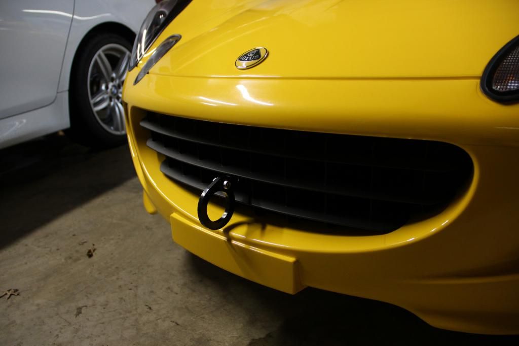

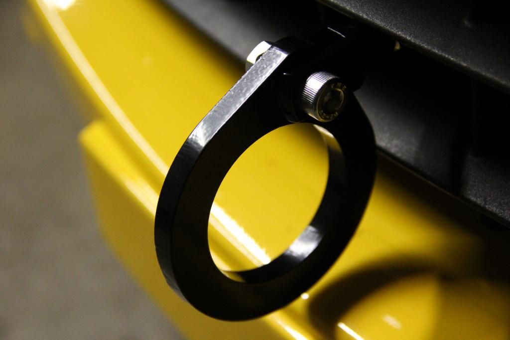

Never liked any of the towhook options for my car, so I made this:
First: Here's it towing a Mack Granite Dump Truck

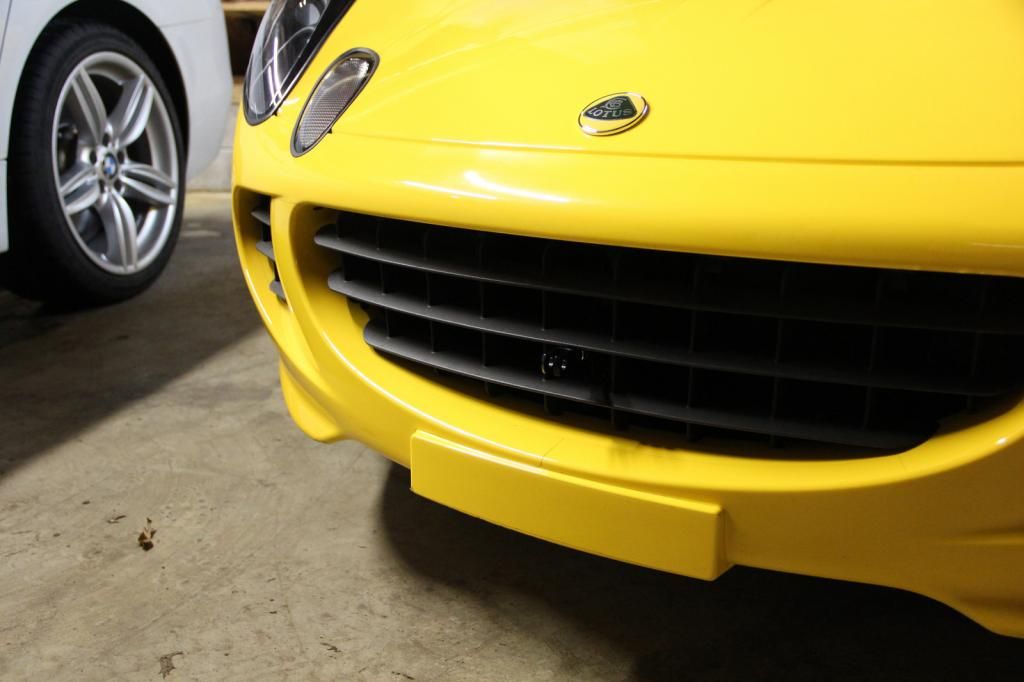

Towhook removed, with just clevis installed

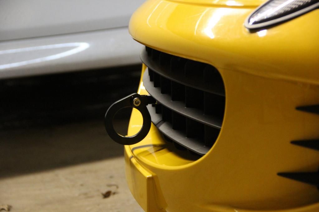

About 1/4" clearance to clam

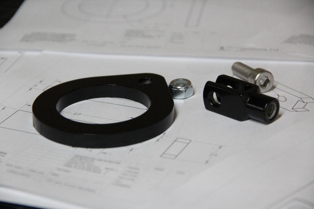

Against CAD drawings

181 Posts
For tow hook just to get out of the track - the design was ok.
I will not trust using it when hauling and putting at the flat bed.
The ring pivot design giving too much pressure in the bolt & the thread.
374 Posts
Discussion Starter · #6 ·
If the tow truck is pulling square to the face of the car it should be fine. Otherwise, should have no considerable advantage or disadvantage vs any other design (when tested against the stock hook, the stock hook actually bent out of shape holding a 1 ton wrecking ball).
