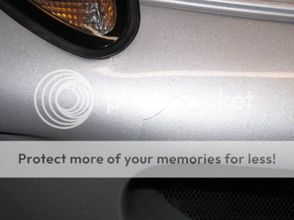

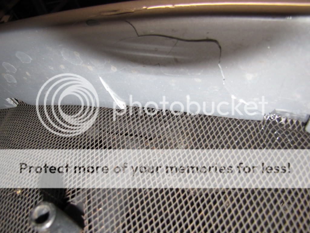

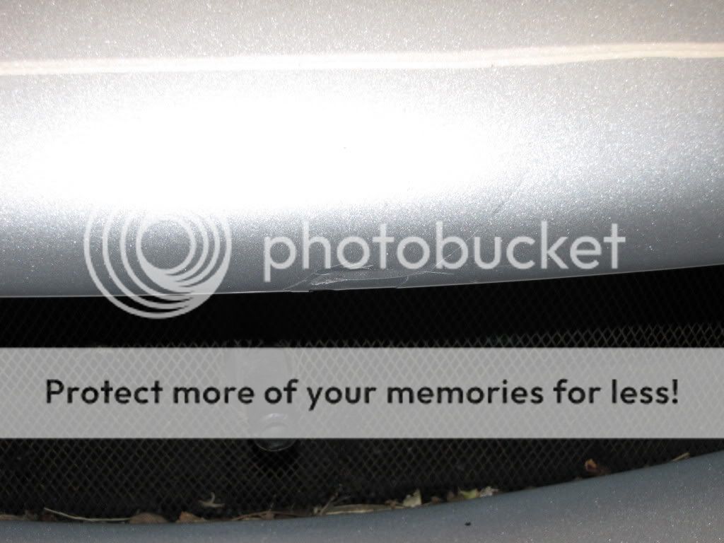

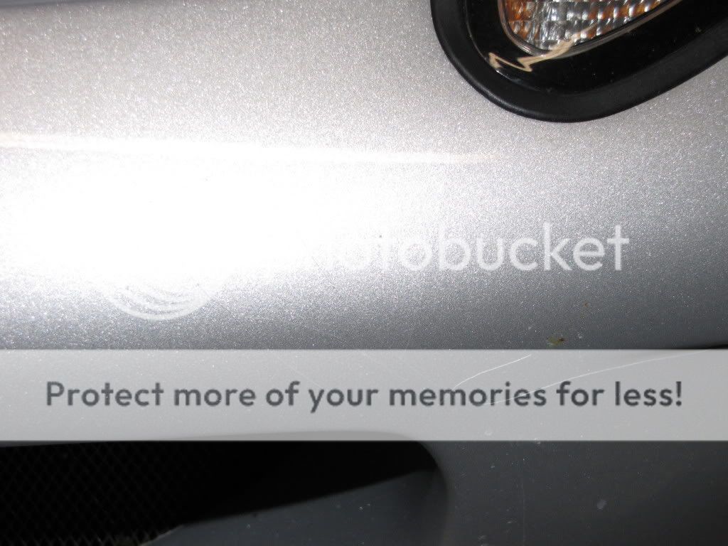

So I'm at a stop light minding my own business and the F-150 in front of me decides to back up so he can go into the next lane. Unfortunately my car happened to be right behind him. Damage wasn't too bad (at least from what I can tell). One crack from the point of impact and then some stress cracks in the paint. I'm being optimistic and thinking that it could have been a lot worse. I about dropped a deuce in pants when I saw him backing up on top of me. I was thinking that the entire front clam was toast.
Anyone have any experience with a claim filed with The Hartford? I know they're a pretty big insurance company but it doesn't look like one of their body shops is SCC. I really don't want to take it to some hack shop that doesn't work with fiberglass....

I would guess from those pics that your front clam will need to be replaced. I certainly would not want mine repaired with that much damage. Those stress cracks will only get bigger with time...

Not what I wanted to hear. I'm hoping that those cracks are only in the paint. He was only going 3 or 4mph at the most when he backed into me from 4 or 5 ft away. Guess I'll find out for sure when I take it in :(

anything "could" be repaired. but if you are taking it to a shop the labor to fix (to high level) would be about the same as new - i say you are looking at a new clam .
i think once you see the back side you will be suprised and want a new clam - probably a fair amount of destruction, just that most of it has returned back to position. and you will want new.
since the elise clam is injection modled, not matt - replacement is prefered.
fyi - the entire clam , front and rear, IS the "bumper"
probably around 9-11k depending... blending the lotus metalics / and or matching metallics at adjoinging panels seems to not be an easy thing.

I went out to the garage this morning to take a look at it and there is a crack under the passenger headlight as well as damage under the car.
I just got off the phone with my insurance and then made another call the SCC. Those guys rock. I asked for the run down as far as having the clam replaced and not patch. He gave me all the details of what takes place when they replace the clam.
