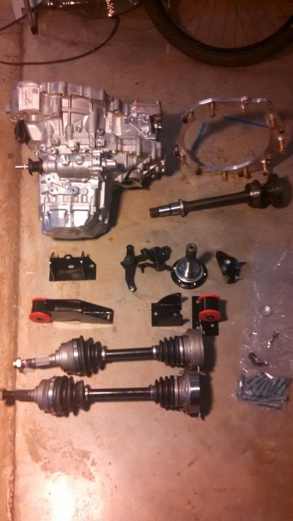

So here's what came with my kit. It was missing about 6 bolts and the shifter cable adapter bracket. MWR was nice enough to mail the bracket and 4 bolts quickly. Maybe they smoke dope at work. I dunno. Oh, not pictured is the flywheel that is a specialized part. That's probably where a lot of the 2800 went.

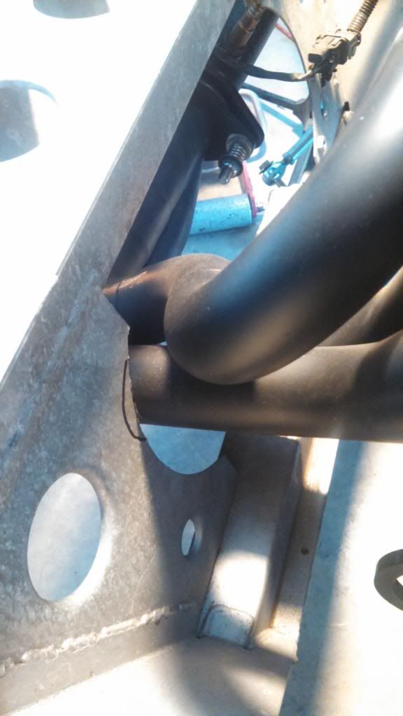

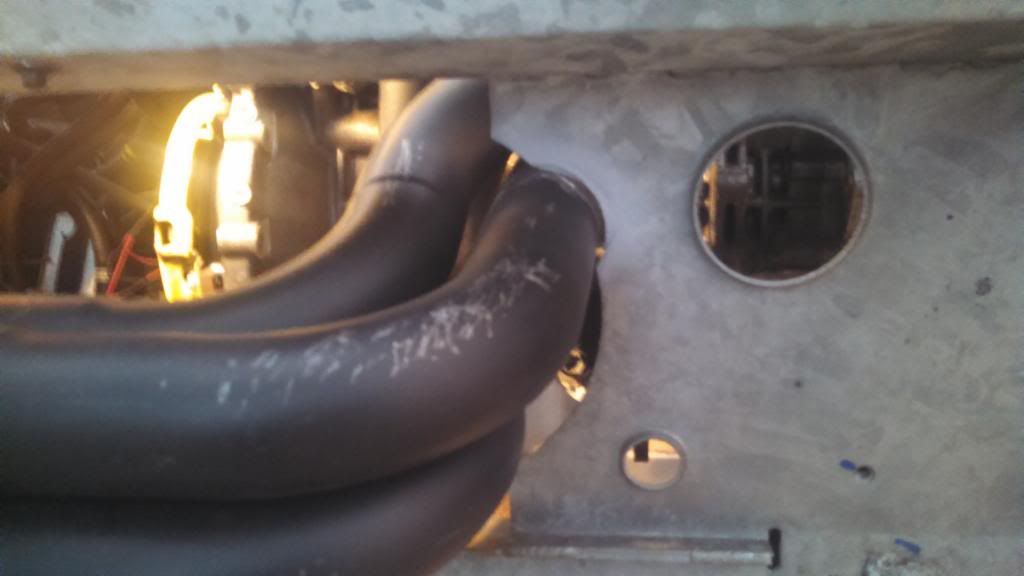

Here's an interesting tid-bit: The new mounts move the motor to the passenger side a bit so if you are using a PPE header, you'll need to clearance the subframe. I used a hole saw.

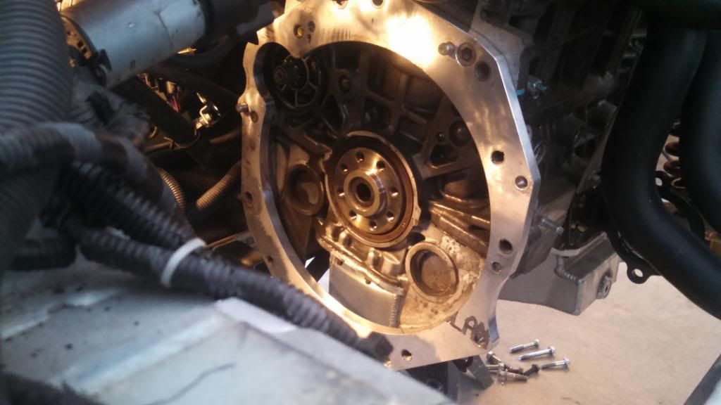

Here's the adapter plate mounted to the motor. One of the bolts didn't align. Matt at MWR said it would be fine missing the bolt. What ever. I'm sure it will be. You can see the starter mounted too. You have to drill out the threaded hole in the starter because you put both starter bolts though the backside now and they sandwhich the block between the starter and the adapter plate. It's a pretty good solution.

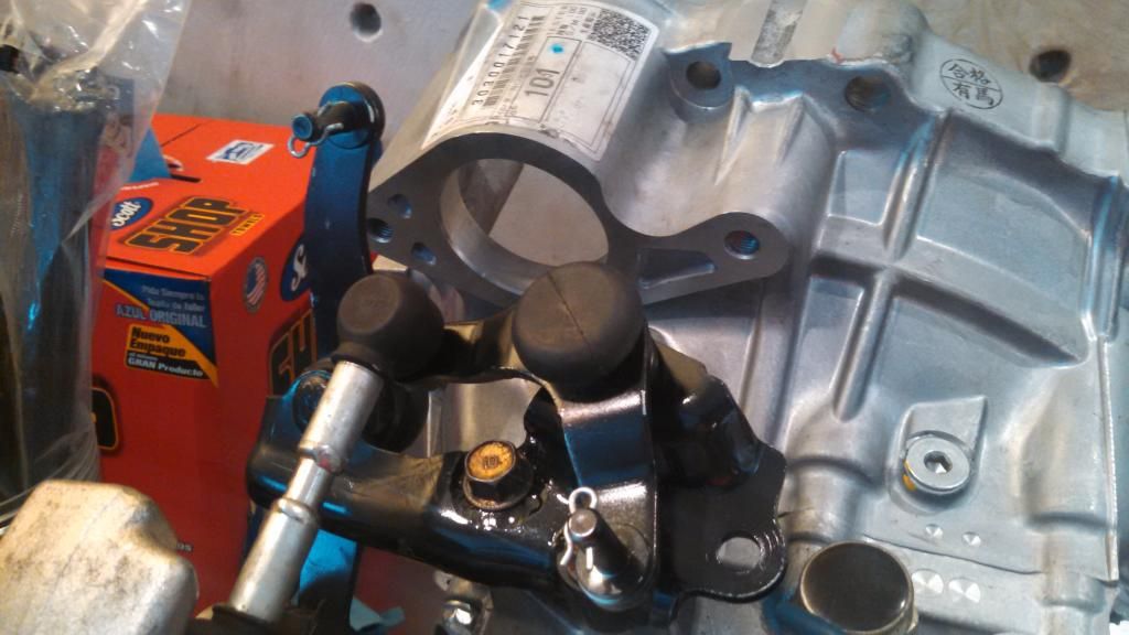

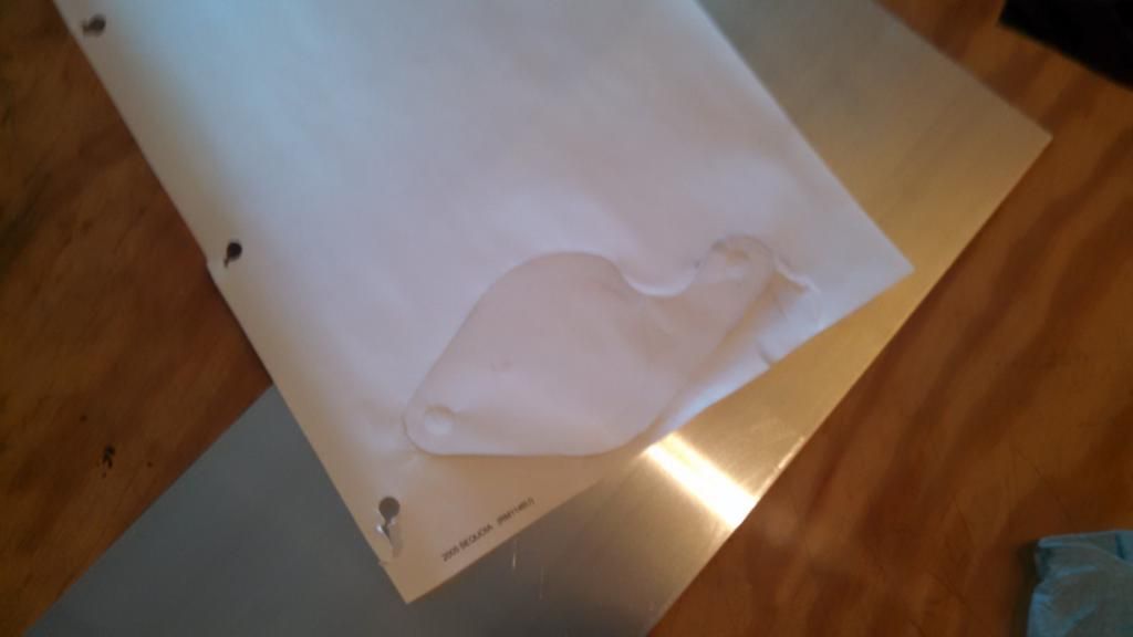

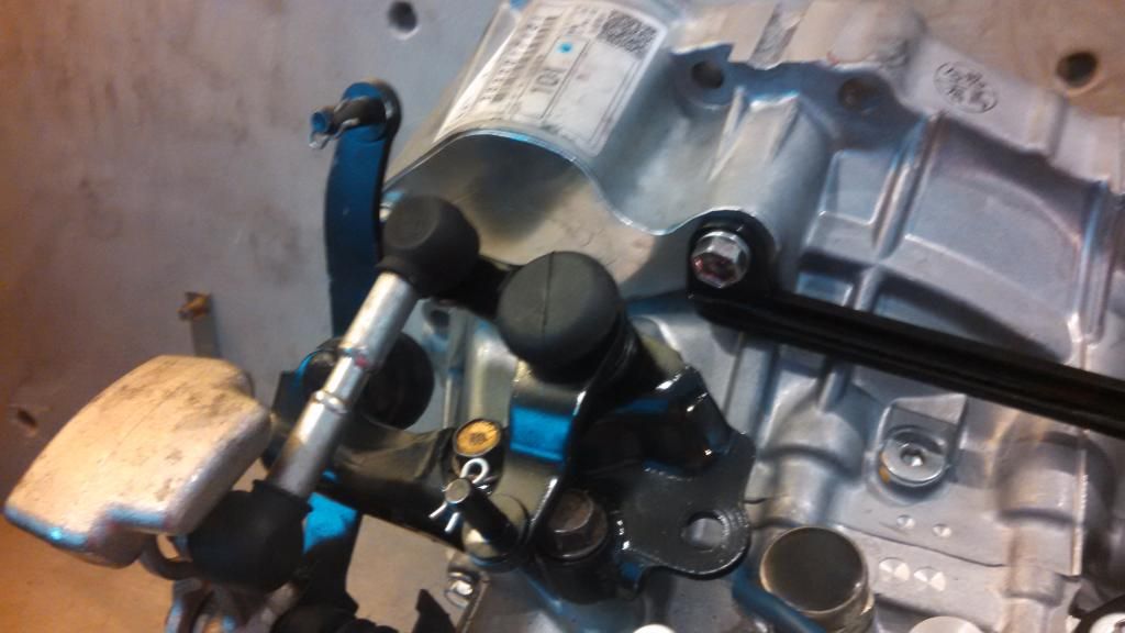

This is the new shifter mechanism. The two bolts that hold this to the E153 were not provided. Lucky for me, I've got tons and tons of spare car bolts. You can see the MR2 starter bolts from this side. MWR doesn't provide a blank off plate for this orifice so I created one from some aluminum. I held a piece of paper on the profile and pushed on it with my finger to make a traceable impression.
Paper impression:
Blank off installed as well as the missing shift cable mount.

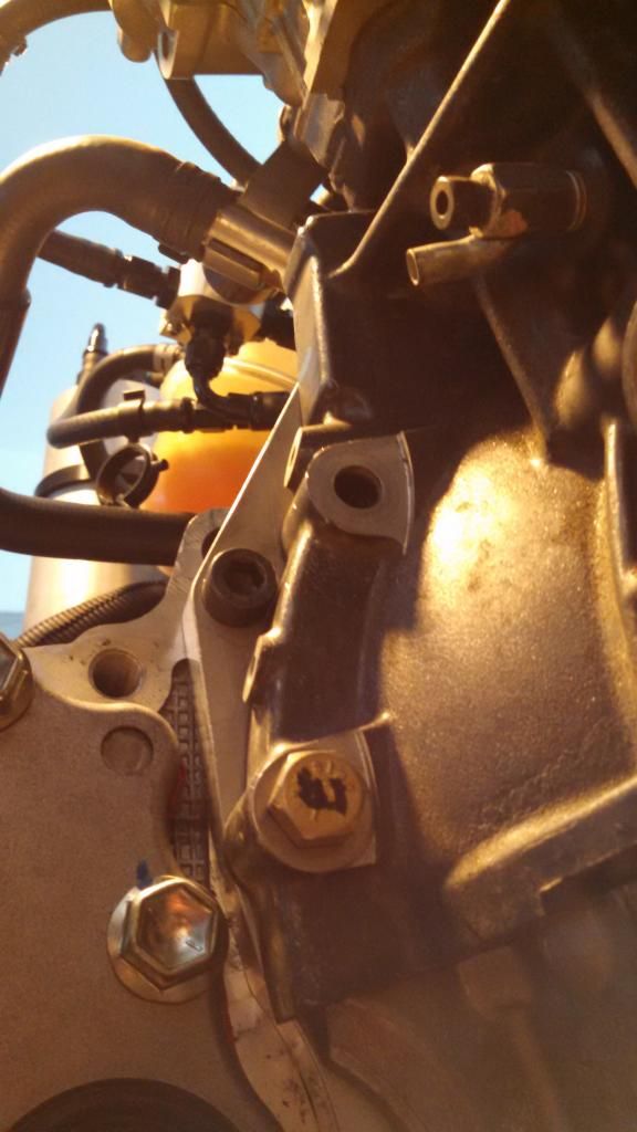

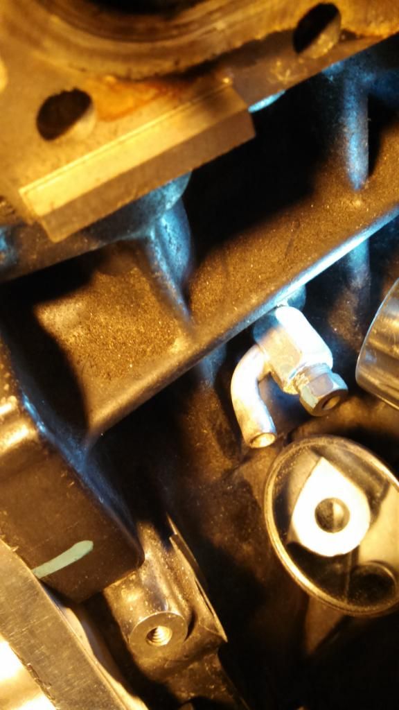

Here's a pic of the spot that the bolt hole doesn't align. You have to file down a small tab on the bottom of the block to fit one of the adapter plate bolts. That wasn't too tough. It's only about 2mm of material.
Look in the hole. It's metal where threads should be. hmmm

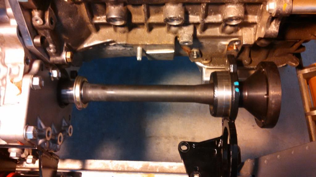

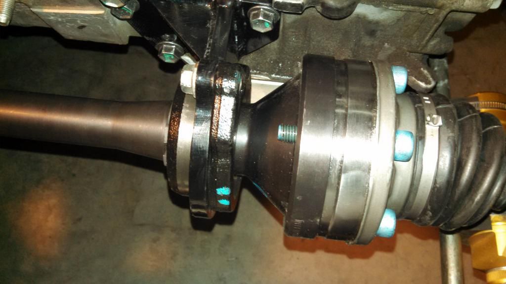

Now on to the axles. My intermediate shaft came assembled incorrectly. I had to undo a snap ring and swap the spacer and bearings so that the intermediate shaft would get good penetration into the trans. No biggie but still... $2800... come on guys.

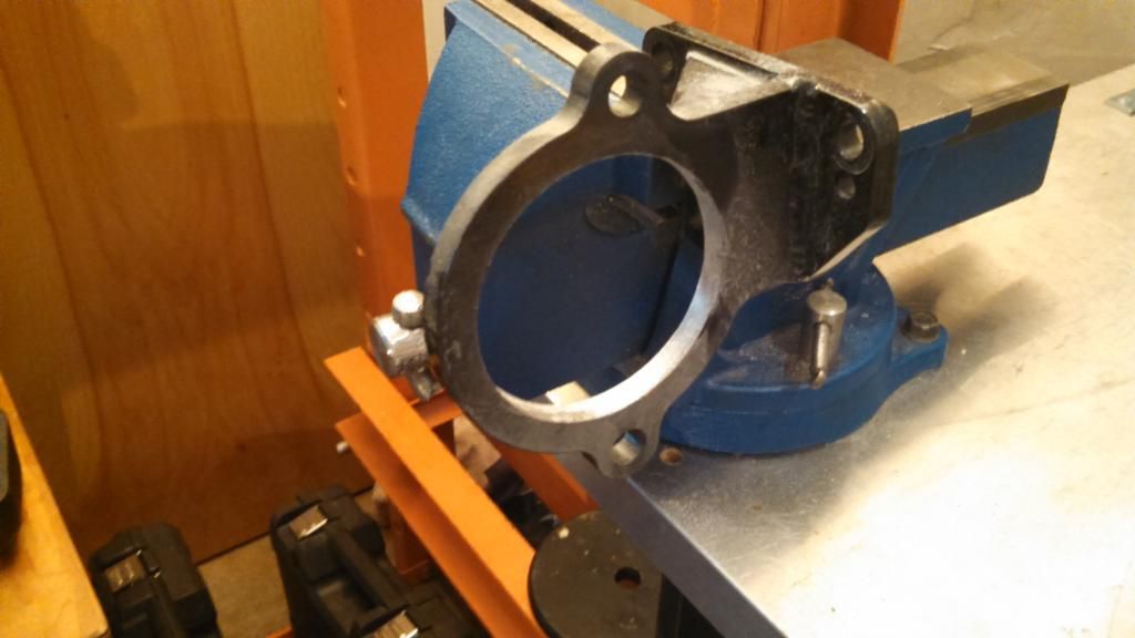

Next, the intermediate shaft mount that goes on the block needed ground down on it's mating surfaces because in addition to the thickness of the powder coating, it's also too small to fit the axle. Nothing was easy with this kit.
Why was one axle bolt of 12 provided extra long? I don't know either.

The shifter isn't quite right either. On my 2008, I had to remove the block that limits the leftward motion of the shifter... it's the reverse lock out. I'm not sure all the lotus years are like the 2008 so that might not be an issue for you but as it sits in stock form, getting into 1st and 2nd was almost impossible. With the block removed, shifting is ok. I still need to adjust the cables to be 100% happy.

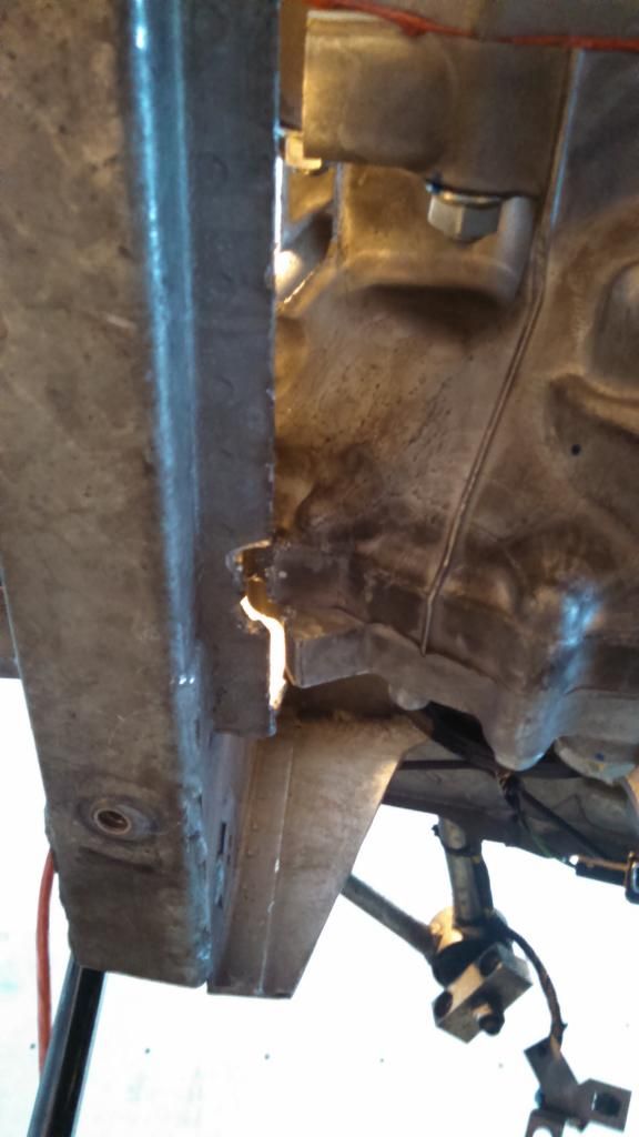

It was either cut the subframe or find a way to raise the rear mount. I needed to raise the rear mount by about 1/2" so I didn't think spacers under long bolts would be that great and there wasn't enough mount surface on the trans mounting side to slot the holes effectively (this would have been preferred).
I choose the simple solution to cut a 3/8" by 3/4" section of subframe. I'm comfortable that the flange of subframe that I cut experiences the lowest forces possible in the cross section of the total frame area. It's really just a flange used for welding the upper and lower section of "beam" together. The top and bottom chord of the beam experience the highest forces and they're still completely intact.

We've tweaked a couple of the brackets to provide a little more clearance when fitting. Minor grinding of the engine lower tab is still required to fit one of the bolts, that's just where the bolt needs to be. Most headers and turbo systems fit fine but the PPE header does require a little trimming of a cosmetic section of the rear subframe (not remotely in any danger of affecting strength.)

I'm installing mine now and the misaligned mount hole is exactly as mentioned. I decided to widen the engine block hole a bit and was able to fit the bolt no problem. It was a pretty quick fix. Just to note I purchased the kit quite some time ago so likely had the same batch of adapters. I also had the close ratio KAZ gears installed. I'll post update later.

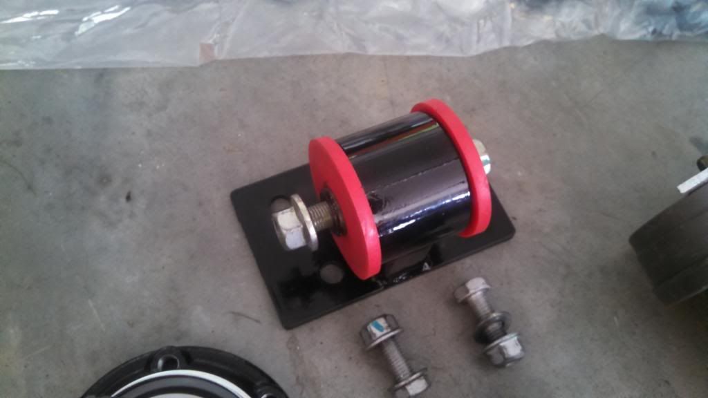

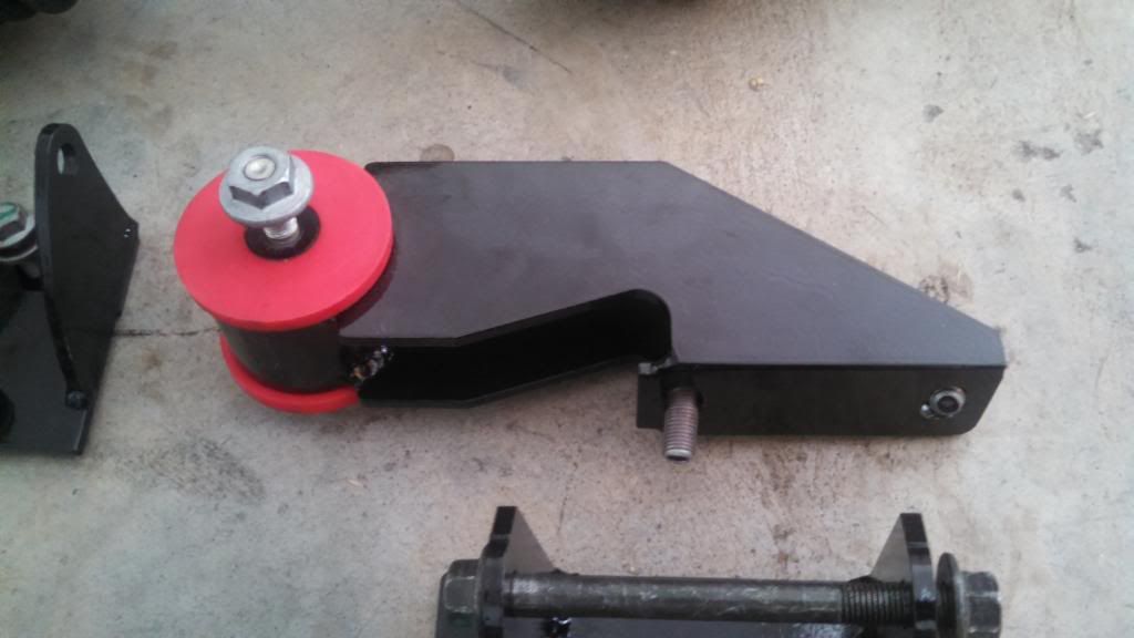

OK so the OEM bolts definitely do not fit the MWR front and rear motor mounts. The front just needed a small diameter adjustment which I did with a bench drill. Fits no problem. The diameter on the rear is way too small for the OEM bolt which is substantially larger than the front. I also noted it is too short in my case offering only 1/2 a nut worth of threads to tighten. I am going to order a new bolt 10.9 grade likely 7/16th with the proper length.
1,636 Posts
I also noted in this post the mounts are red. My motor mounts are all black. I wonder if the material is different.
