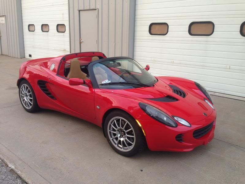

I know there are a few of us out there , this is a thread about the ups and downs of a car like mine . I got it a year ago for a great deal ( less then 20k) it ran and had a clean car fax and passed a PPI with flying colors so I bought it .. Car is still amazingly tight and everything I wanted it to be . I drove it all summer and had a blast a few weeks ago I got it back out and began the task of fixing all the little bits

The few things that bothered me were that the inside was gross , and it had no non oem wheels (on a plus note they are great light weight wheels and match my audi s4 ). The nose badge was a goofy "queens mark"

Later I found out the badge was just a sort of sticker cover. Though it looked like a badge. Under it was a legit lotus nose badge !! So with some rubbing and cleaner I was able to get that off

The other thing that bugged me was how much these lights suck ! Maybe it's because I drive cars with HID LAMPS but god damn these are horrid ! Only one way to go hid install. I could have gone with a drop in. But I don't like sending that much current through the headlight switch , so I opted for a relayed kit from retrofit source
