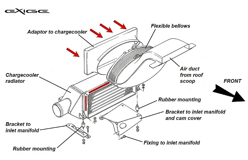

I am trying to replace my OEM adaptor to chargecooler with a CF one. I am wondering if there is a special way to remove it from the chargecooler radiator? The OEM adaptor to chargecooler is not moving at all and I am wondering if it is glued to the radiator?

It is glued, fastest way to get it off is to cut and break it. Run a sharp blade between the shroud to the charge cooler.
