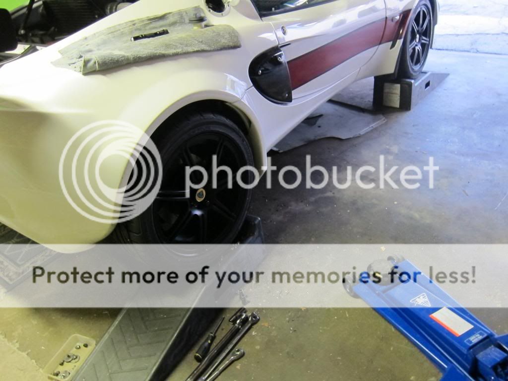

Step one was raising the car up. I don't have a lift, but I do have two sets of the big plasic ramps, and a good floor jack, so that got my car off the ground.

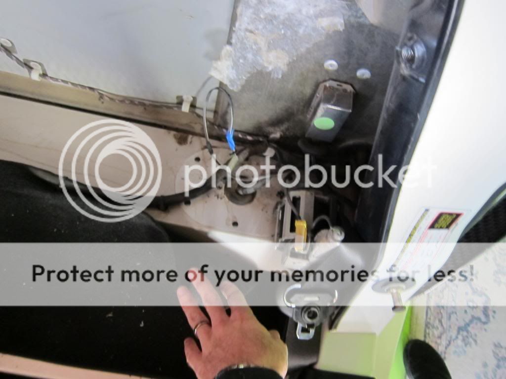

Step two involved removing much of the interior. Pulling the seats out is not too bad (Although the passenger side is not much fun to put back in.) The most annoying part is the seat belt cross bar. Once I had the rear speaker enclosures out, I found there is enough room to get a 1/4" socket wrench in there, it just takes a long time to remove the bolts.
Once that was out, I pulled out and cleaned the rear plastic. I also took out the center console, but that turned out to be unnessecary. Then I had to unbolt the driver's side seat belt reel to get clear access to the fuel pump firewall cover.
Then I could disconnect the fuel line, and the sensor and power connectors. Some minor blood loss was experienced due to all the sharp aluminum edges, but that was expected.

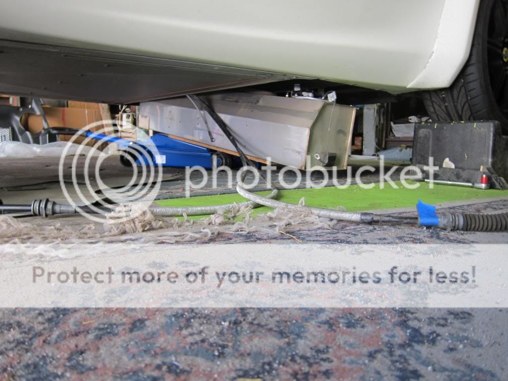

Getting serious now- I used my floor lack to support the tank while I removed the tank brackets. Then used it to lower the tank to the floor. (It was, of course, full when I did this!) I could then slide it out from uner the car, spilling almost no gas!
Here are some comparison photos of the stock tank and the 60L tank.
I weighed them both to confirm the numbers I'd found online. On my (super accurate!) bathroom scale, dry, and without the pump assembly installed, the new tank was just over 12 lbs, and the original was more than 26 lbs. This seems like a pretty sneaky way to remove mass and gain capacity!

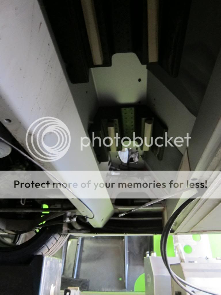

Here is what the room the tank occupies looks like:
Those hard closed cell foam spacers have to come out. That is where the larger tank gains it's volume.
