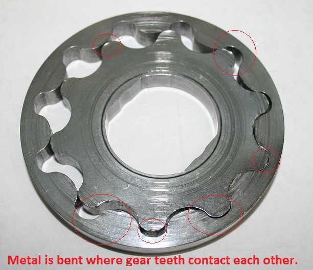

We started working on a solution last year that we believed would be an effective replacement. We had it made from billet 4340 steel, REM finished and precision ground. We tested them on track and data logged our results. We blogged about it: HERE. We thought we had a good product until we removed it from our engine to inspect it. The gear teeth had deformed. Clearly it was not ready for prime time so we went back to the drawing board.

We installed the first configuration and took our test Elise to our race shop at Spring Mountain for testing. We put about 290 track miles on the gear and recorded the conditions. Oil pressure looked great and the car ran fine. We removed the gear and found that we had made some improvement but still showed scoring on the teeth that was not acceptable. See picture below.

Casite is your friend if applied to the ends of the central gear and the valleys of the exterior gear. Alternately a gear out of O1 (oh one), which is an oil quench steel, which has had clay masking for the soft parts (or a quench jig) will allow you to selectively place the hardness where it is needed, and soft where you need the toughness. Or 154 CM, with a CO2 or Liquid Nitrogen post quench will have the hardness, toughness and ideal wear resistance you desire. (And it doesn't work harden like many other steels). You will want to grind it to desired thickness (versus fly-cut or Lathe) as you would if you were making a pressure plate true. Just some suggestions.
Edit/Update: Re-examining the ends, it looks like a hammering effect. This will occur if the OD of your outer ring has slop within the pump housing, a slight increase of your original outer ring size is merited.
