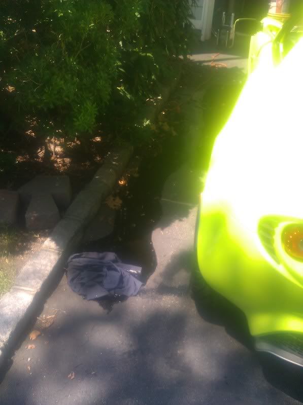

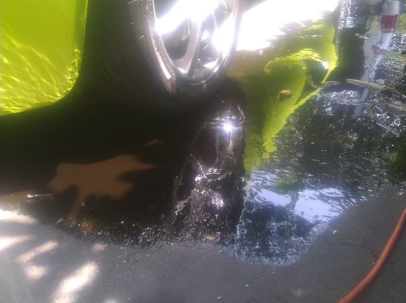

So today I took apart my TB to clean, once i was done i went to start her up, after 20 sec I here a ticking sound as i went to shut her off to check the oil I then herd a knocking sound and shut her down quickly, as I look down at the ground I see All my oil running down my driveway. I knew I have then been hit with the oil line failure. So now it looks like the front clam will be off once again. Now I know what LOTUS really stands for, Lots Of Trouble Usually Serious.. All in all Im glad it didnt happen when I was on the parkway and know one got hurt.

Im going to fix the lines myself but the knocking was comming from the top of the motor. The motor was cold start and the oil pissed out before it made temp so hopfully the motor is fine, but there was no oil on the dipstick when i checked it after i shut her down.
Note.My car has 36k miles

Yes my car is an 06' model, 36k miles. I will post pics once the front clam is off the car. I pulled the inner wheel liner out but it looks fine, it must of blown off on the front part of the oil cooler, hard to see without the clam off the car. I have to pull it anyways to install a new a/c drier line.
edit: I busted out my scope. heres what i found. Hose just slipped right off like it was nothing. :shrug:
