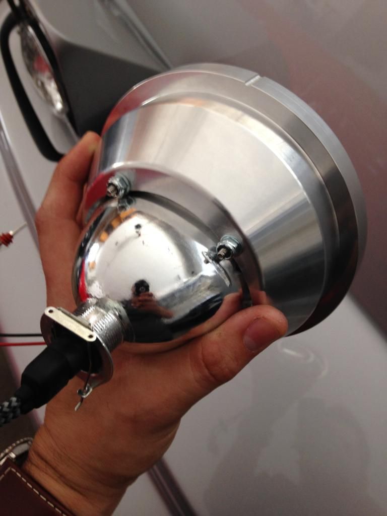

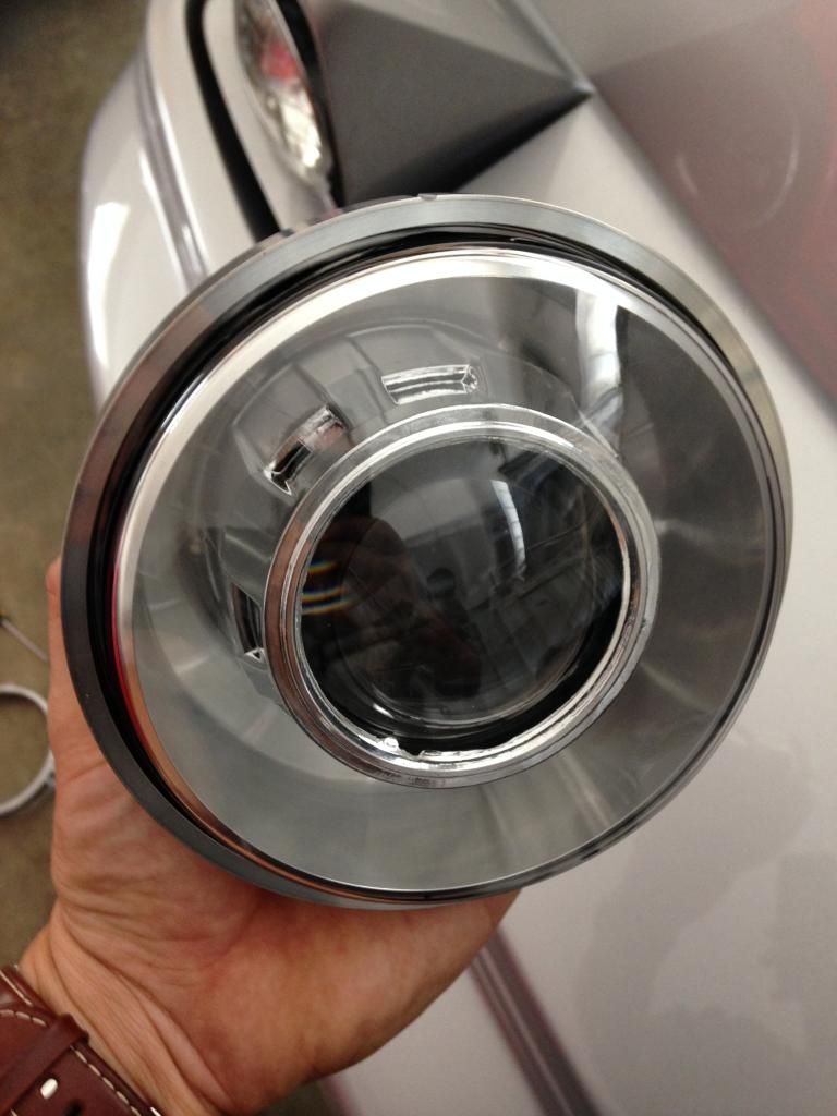

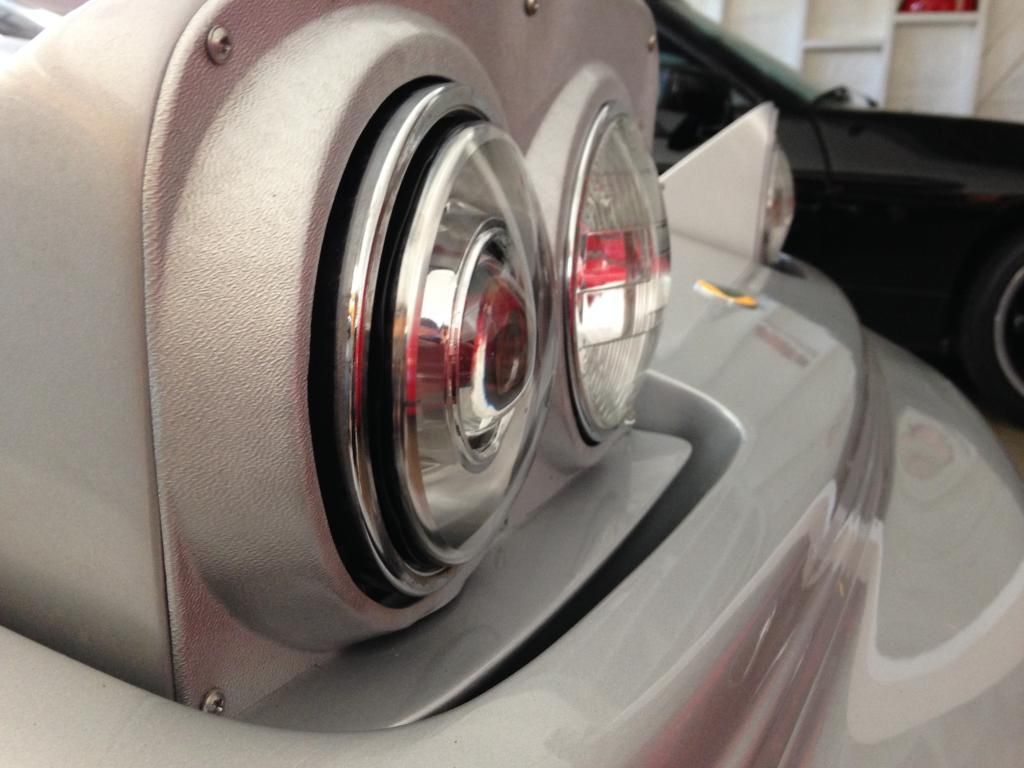

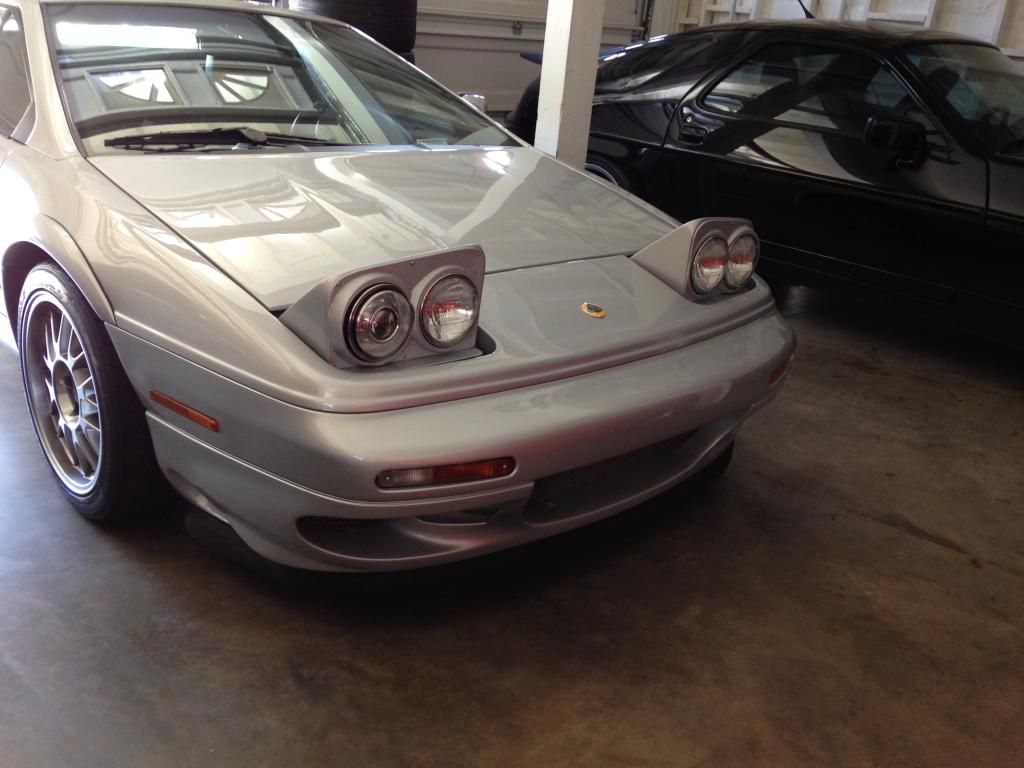

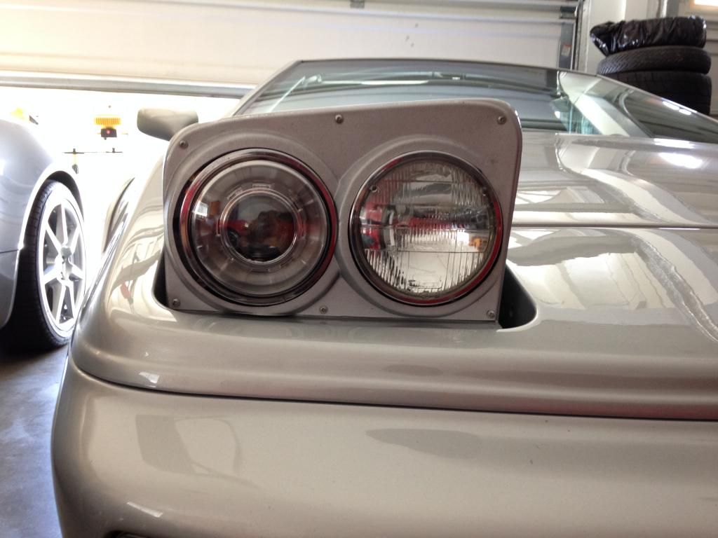

As we all know, there really isnt a true HID projector on the market that fits the Esprit. So we decided to build our own. The projectors have a shutter that set the cutoff for low beam and raise for high beam.
Here are pics of our prototype:

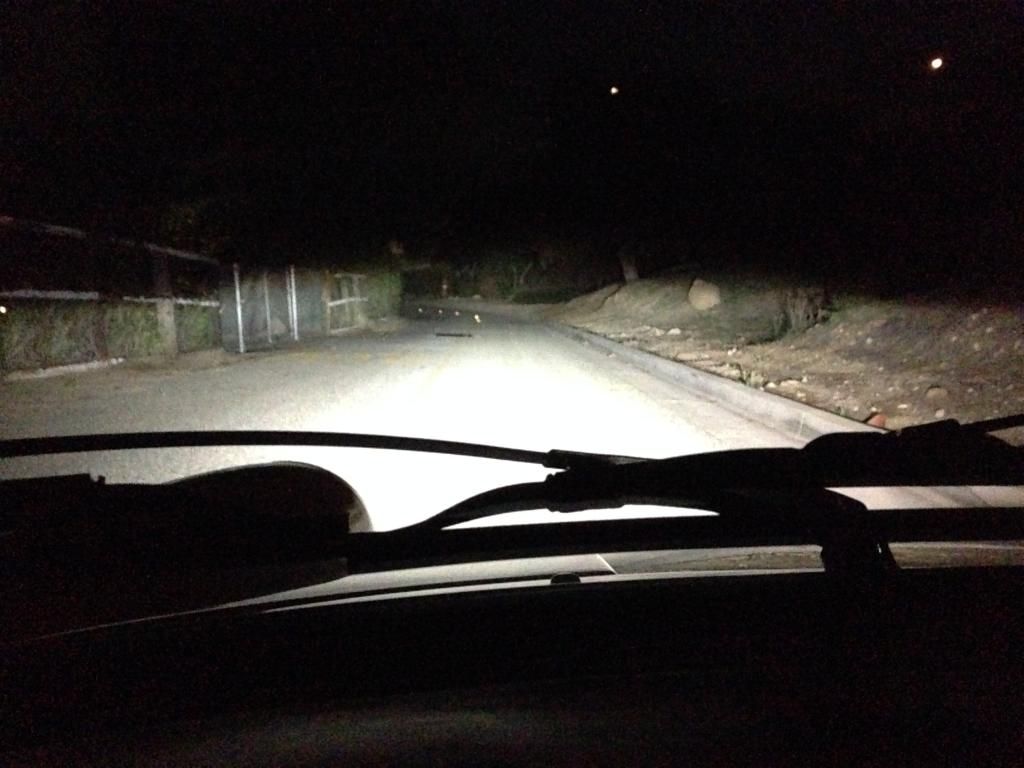

Here's a pic of the same projector used on another car:

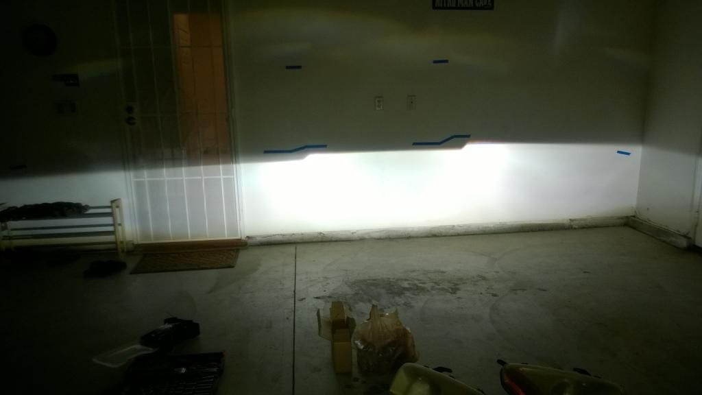

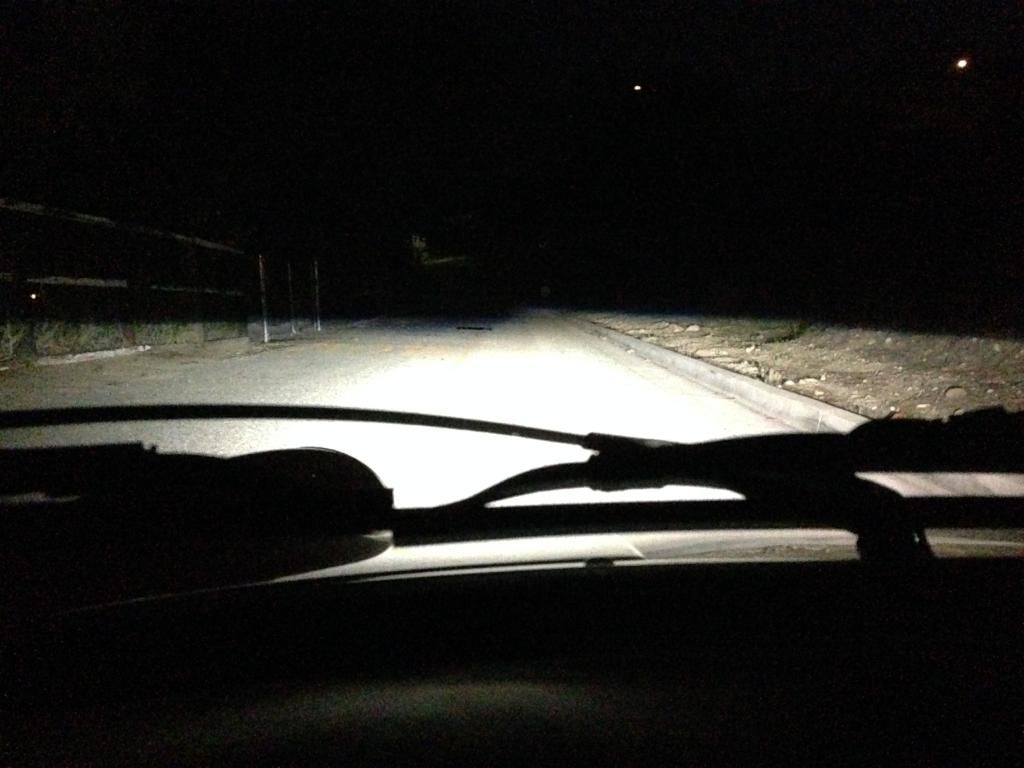

shutter down, low beam:
Shutter up, high beam.
cutoff
I'm still undecided if I want to use two projectors with HID for low/high beam and two sealed beams for high beams, or two projectors with HID for low/high beam and two projectors with halogen for high beam or four projectors with HID for low/high beams.
We should have the final versions done in a few days
What do you guys think?
