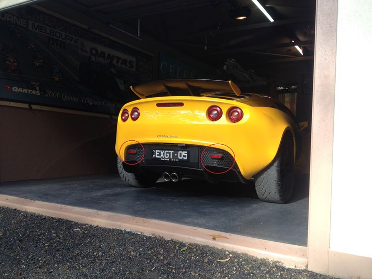

im wanting to remove the god ugly square rear reflectors i have and replace the grills with no cutouts
I ve been told if i remove my square reflectors i have now ,ill be left with a hole :eek:

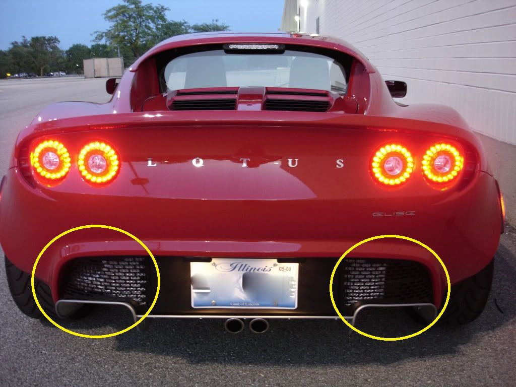

Can anyone tell me where i can buy a set of rear grills for my exige with no reflector cutouts as seen in the picture below,ive looked but cannot seem to find any,im not even sure if they are available for an exige or not ?
cheers Si
what i have
what i want

Yup! IMO the reflectors are the easiest way to quickly tell an '05 from an '06+ without looking closely.
OP: you're looking for the stock grilles off of an '06 Fed Elise, but NOT a later one as they added "bumperettes" which you probably don't want either.
The OEM part numbers are A120B0149F and A120B0148F

thanks bri3d,ive got the later model led tail lights,just not fitted in the picture i posted
thanks,thats exactly what im after,i presume elise and exige grilles are the exact same then ?
i want your grilles Derrek :)
have you noticed my 05 exige has grilles with round holes,yours has oval holes,thats a bit strange,must be something with federal versions maybe
945 Posts
Federal Elise and Exige grills should be identical, again provided both cars are '06-'07.5 (when the "Bumperettes" were added).
I also know that there are different oval/round hole options, but I think all of the grilles you want (no reflectors, normal diffuser fitment, no exhaust holes) have oval holes.
Some European market cars had round holes instead of the oval ones, but I think they all had some combination of reflectors or exhaust cutouts in the grilles. The Fed Elise parts manual only lists round holed diffusers in either the reflector or "B or C diffuser" configurations.
