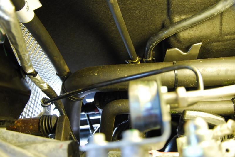

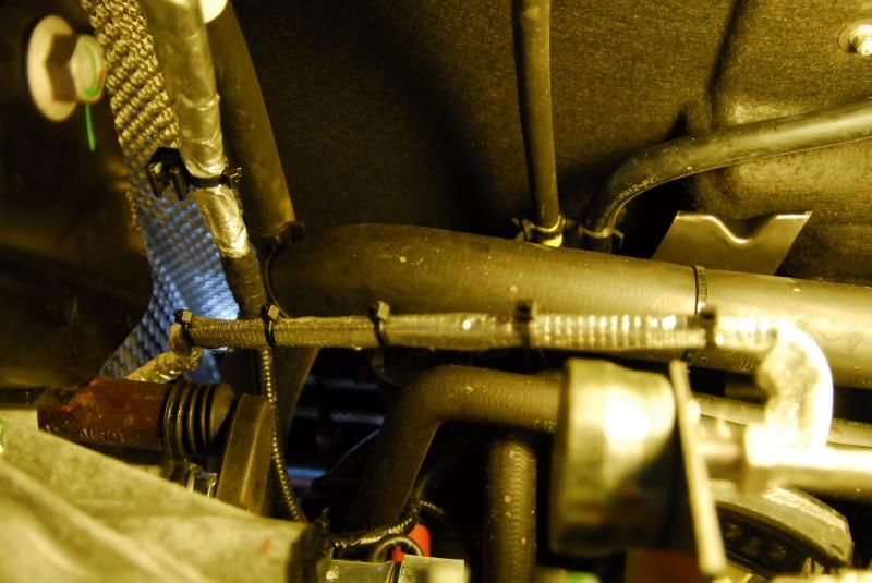

Saw the original SB, don't have a copy. I had this one done yesterday:
Applicability: Evora S
Issue: Clutch pedal falls to the floor, resp. loss of clutch action
Cause: Boiling hydraulic fluid due to overheating in the engine bay
Correction: There is an additional piece of thermal insulation, that should be mounted on the hydraulic line close to the clutch cylinder. The hydraulic line then has to be vented and refilled.
My clutch pedal fellt through when I started the car on Monday. After pulling it all the way back up I was able to return home (300 KM), but with a very soft pedal. Afterwards I recollected, that the pedal had become softer over time, I've done a lot of high speed driving, so the engine bay gets very hot in that area.
The dealer didn't have the riginal thermal covering, but he improvised. Draining the system was acutally the much bigger chore. Its really tight under that engine and the cluth only refills at the very top end of the pedal (which meant holding it up until all the air was out.
