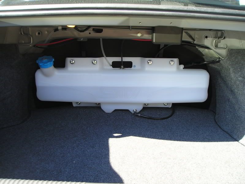

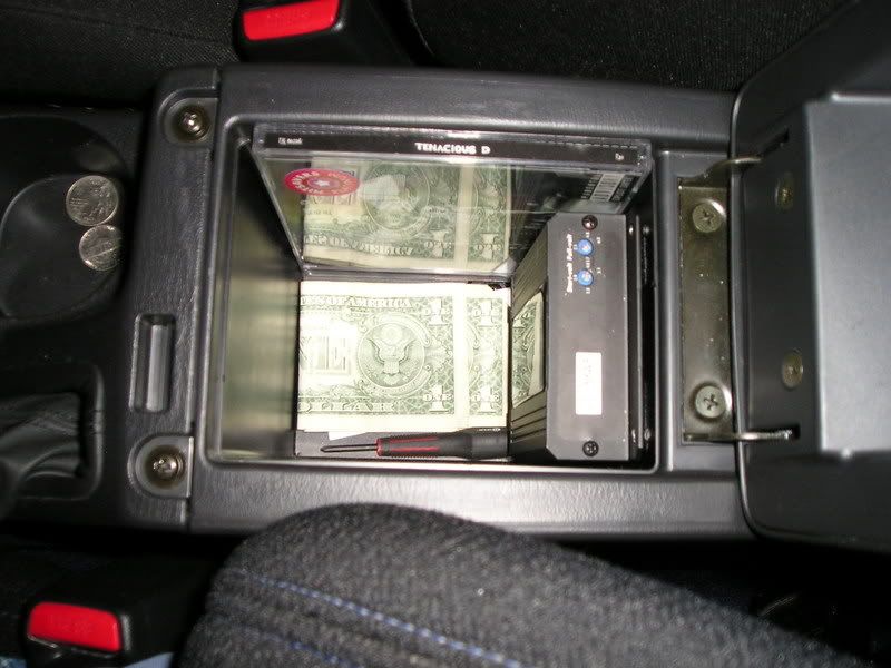

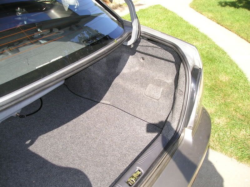

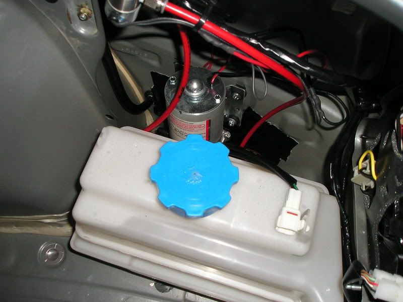

I had Meth Injection on my 400 WHP Evo8 and it was an absolute pain in the a** to keep that reservoir filled.
Might I suggest to not keep your reservoir up your azz?....:cool:
All kidding aside, it is not for everyone... it is another system on your car that requires care, attention, and maintenance. If you, or someone else, is a "set it and forget it" type of person...well then a meth/water injection system is not for you.
Asfor keeping it filled, I have about a 4gallon capacity in the trunk of my STI...except for track days, it lasts quite a long time...as I don't find myself driving on the street hard enough to have the spray trigger for longer than a second or two. Here's a fewpics of the tank, pump, and controller in my center console...
Here are the results of my install with a proper, conservative roadcourse-based cusom dyno-tune and AFR/Boost curves... Please take note of the massive increase in spool and torque - it completely transformed the car...
