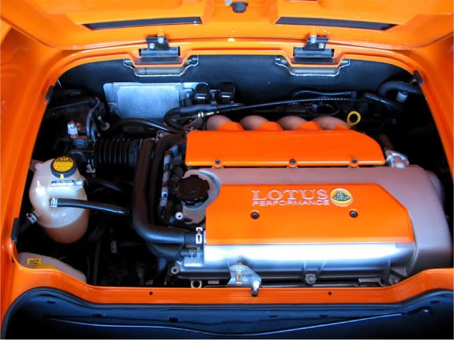

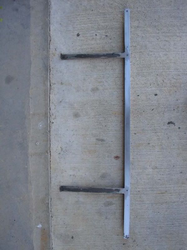

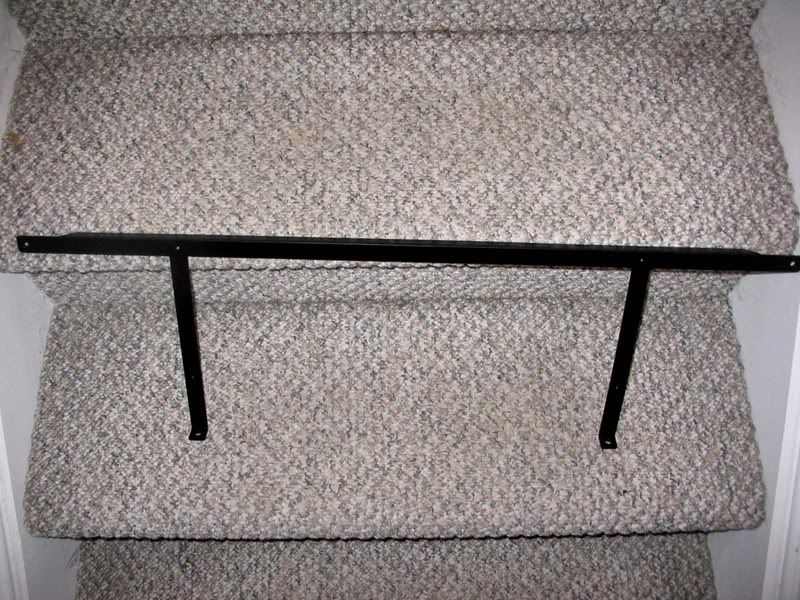

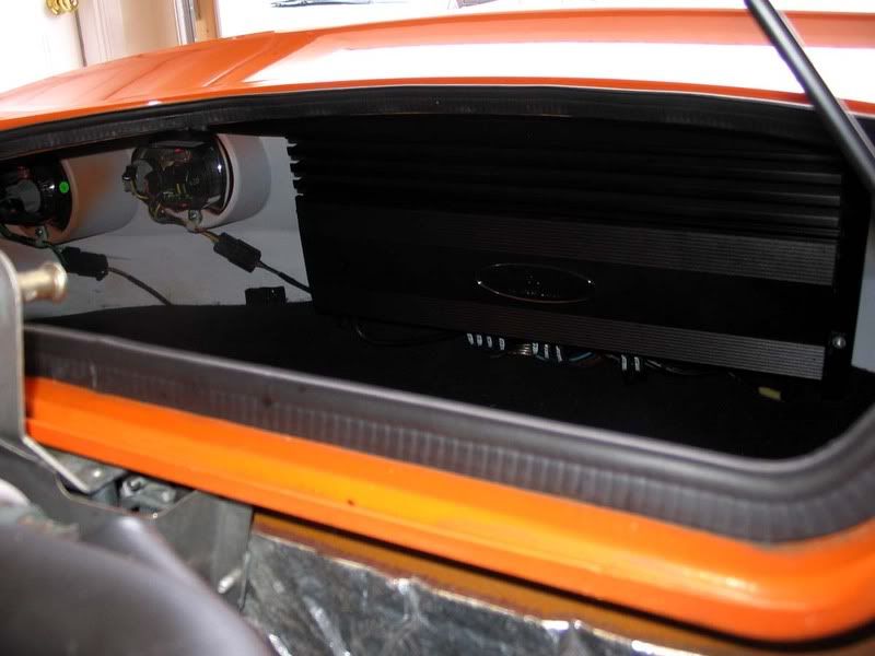

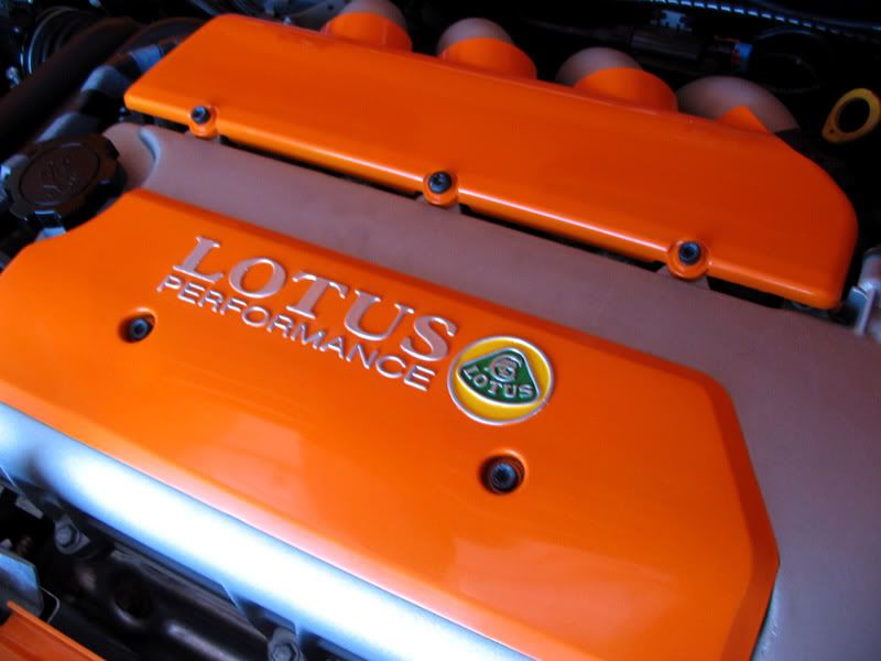

I got bored last week and worked on a new bracket to hold my amp and painted my valve covers. I had another amp rack but it busted, it bolts onto the taillight bolts and underneath the trunk carpet...

very nice...can I ask what type of paint you used on the engine cover? On my first elise I painted my covers with touch up spray paint from automotivetouchup.com, but eventually there was some mild cracking/peeling, so I was wondering whether this time I should use something more heat-resistant...
6,301 Posts
did you use any adhesion promoter on the cover first?
774 Posts
i used krylon fusion yellow, then silver, then orange.
After that I went over it with clear and wetsanded the crap out of them
Presuming the clear is enamel too, right?
I did mine last month too, and baked it in front of my fireplace vent for 3 days straight after. The enamel literally bakes on wonderfully.

Sorry i dont know anything about painting. Why yellow then silver then orange.
Second, how did you get the lettering and emblem done so crisp. Hand painted? Please include details. :D

The CO paint is kind of this candied orangy yellow metalic.
Since I dont have a spray gun to try and replicate it exactly I tried to mix a bunch of layers together to get it as close as possible. It actualy matches really well. The letters and logos are just painted on with enamels by hand

Man it looks so good. I really wanna do it but i cant even draw a straight line so hand painting the emblems makes me nervous to say the least.

Can you describe what use used to 'wetsand'?

so I guess krylon is pretty heat resistant? Did you mask off the letters, logo at any point? Well i guess you have to paint the cover first mask that off, paint the letters and mask that off and finally paint the logo.

Thanks for the info. I painted mine but it failed. :mad:
Everything went well until I sprayed the clear coat. I used Krylon Fusion (Yellow) first, waited three days then tonight I sprayed KRYLON Crystal Clear Spray Triple-Thick Glaze spray but it disolved the yellow paint. I see bunch of craked shaped textures.
Could you tell me what you used for the clear coat?
