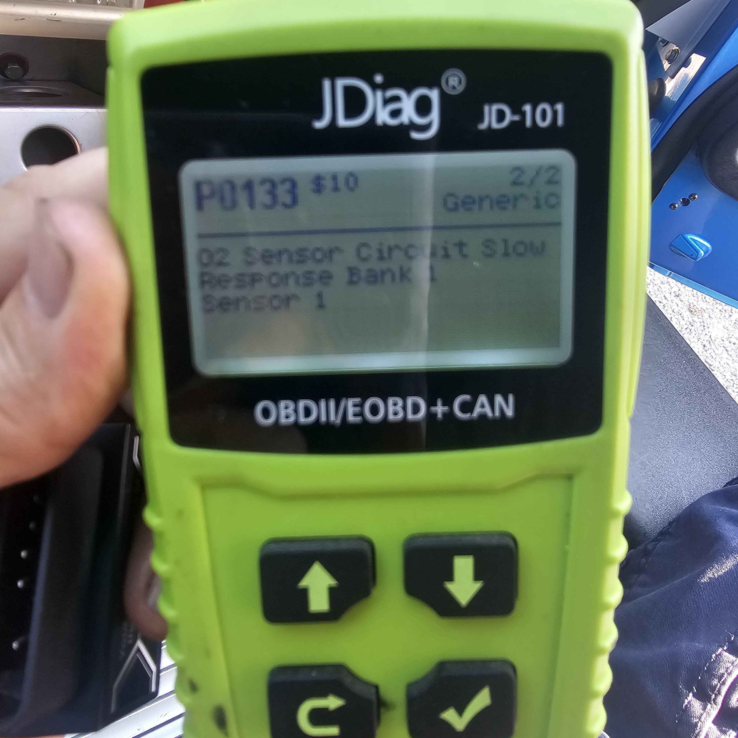

Hey Guys, great to have my car back after a very extensive refresh and maintenance, including a new supercharger - But....
I pulled these codes, though one might be due to replacement of the top TPS 2 days ago.
The shop was chasing a sporadic idle that randomly occurred after putting the entire car back together.
It somewhat improved after the new TPS was plugged in, but didn't completely cure it.
These codes weren't visible when the shop had my car, and I plugged the scanner up when the engine light came on today.
Do you think I need to replace the sensor on the bank the code is showing?
My wideband shows in the low 11's to high 10's, basically gets richer as the revs go higher WOT.
Boost follows the same trend, starts at 6.4 psi and finishes in the 3's by the maximum rpm.
Its 90 degrees out, so air density could be effecting the boost, but I have never seen it drop as it revs.
New belt, new tensioner, new blower, new bypass valve.
I wouldn't think the codes I posted would be causing the boost / AF issue.

Looks like O2 wiring reversed maybe?

Not the o2 sensor plug order. I did the swap with the car running, one unplugged it really started stumbling. Switched them and the stumbling stopped but the sporadic misfire, rough idle continues.
The guys at the shop checked everything from coils to wire harness, fuel pressure, injectors and vacuum leaks. All sensors, map, and lastly TPS changed. I'm stuck now as the Lotus shop couldn't find the culprit.
Aside from new camshaft, lifters, and supercharger, the only thing else they added was the BOE catch can, Ehuast and clam hinge.
