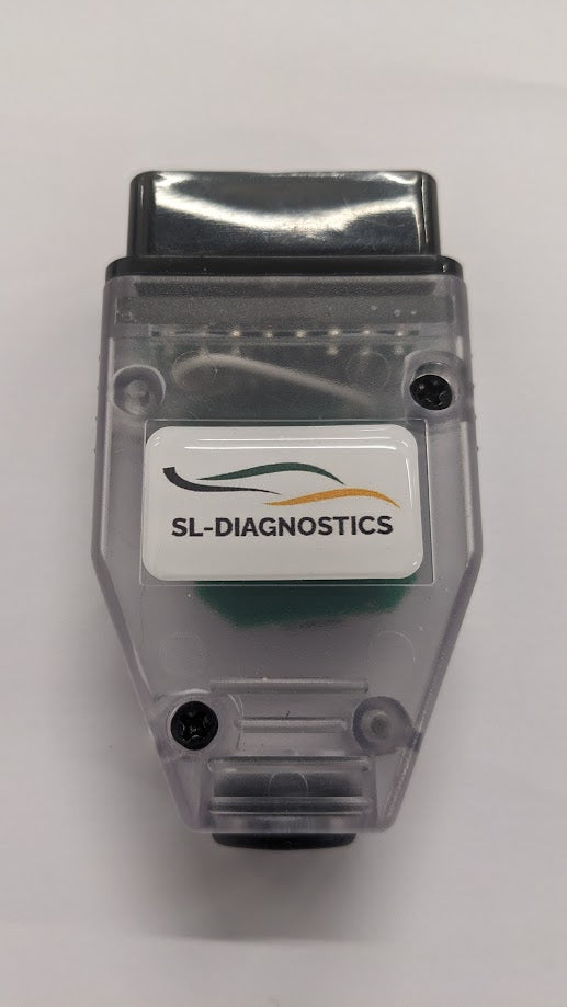

Yeah try another reader. That reader is just for clearing codes IIRC. I have one just to try on 400 but have a SL Diags from GRP for the Evora. I have a Blue Driver that works on Elise and might try as well on the 400.
The SL Diagnostic Device is a cost effective tool to allow fault code read and clear for the majority of Elise, Exige and Evora from 2006-2022 and covers Engine (EOBD and spanner fault codes), ABS, Automatic transmission, Airbag and TPMS (more are being added as we continue to test). Simply plug...
I only use the Foxwell to clear airbag codes. I use the early version of the one @Catsailr27 posted for diagnostics.
