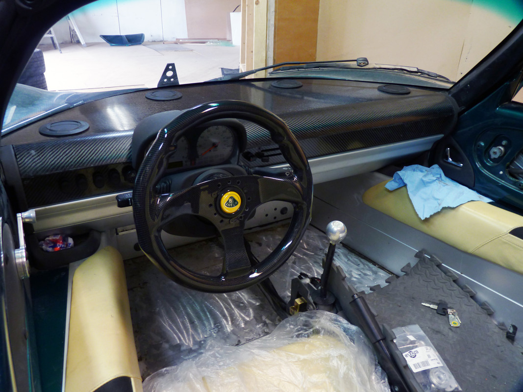

It took my a week to complete the LHD conversion. I did not buy a LHD dash, I had decided to make my own using carbon fiber.

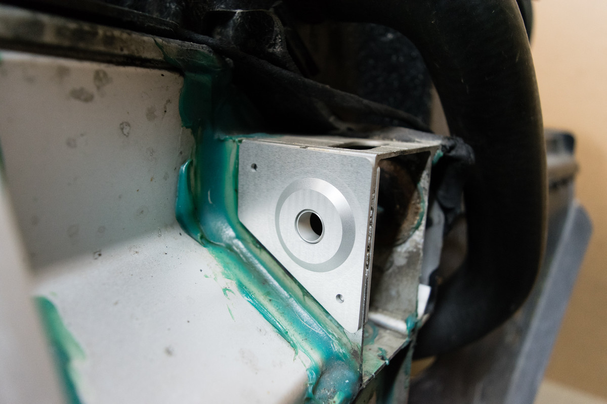

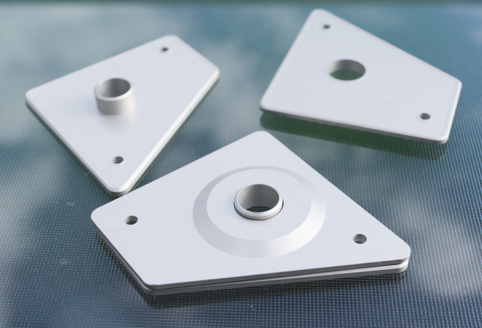

I also found some significant corrosion around the front suspension mounts bobbins. I designed and made my own sandwich plates to replace the steel bobbins and thus significantly reduce further corrosion problems. They are glued in place, like the OE bobbins. I have not noticed any wear or corrosion since then.

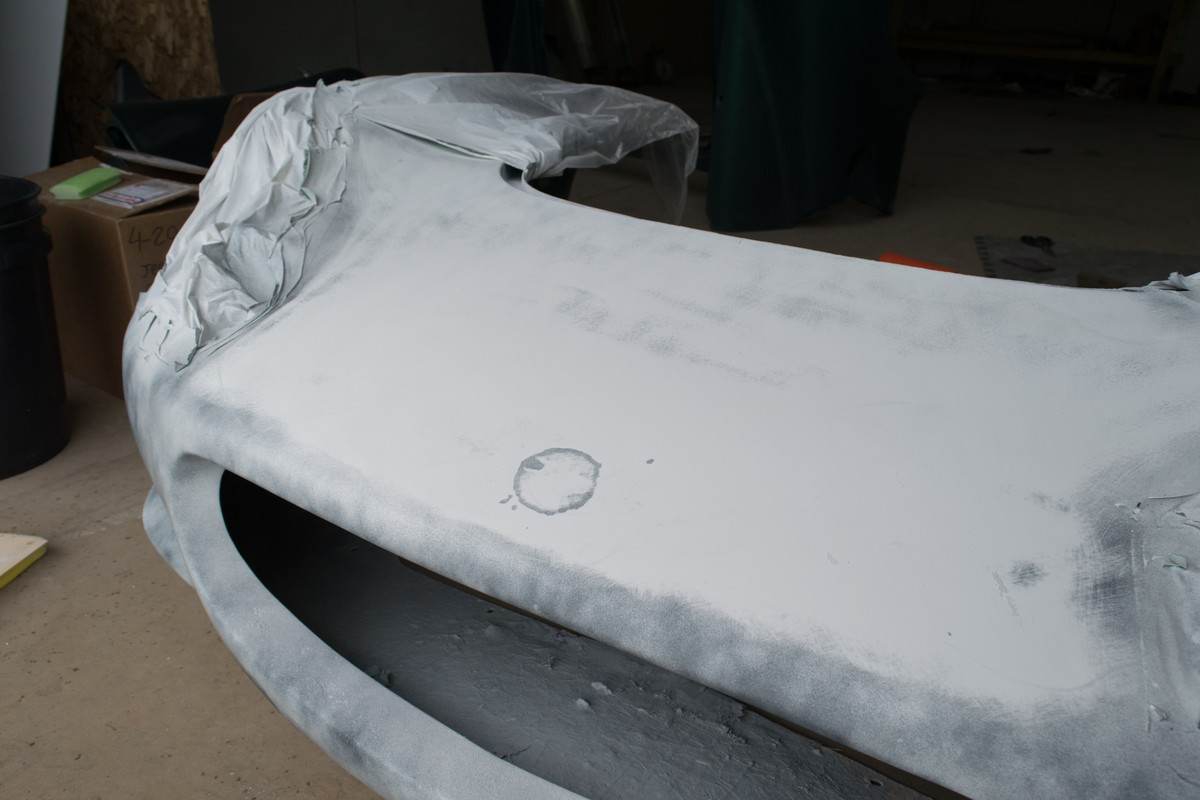

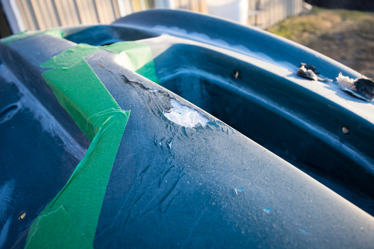

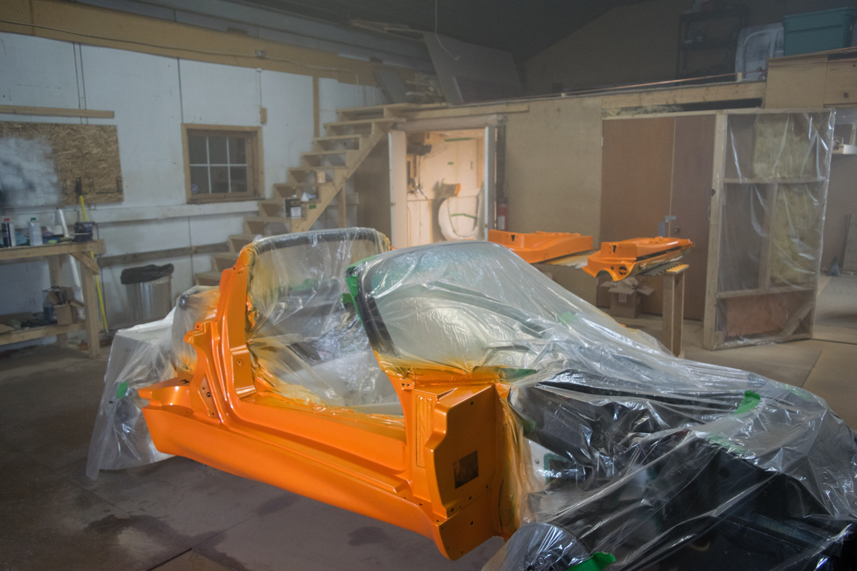

Then at the end of the summer, my landlord backed into my little Lotus with his SUV in the yard and broke the rear clam. It didn't do much damage but he couldn't afford to pay for the repairs and wanted to go through insurance. I didn't want to stain my spotless driving record so I bit the bullet and decided to learn to repair and repaint the clam myself. Since I was a fresh graduate, I had a lot of time on my hands while looking for a job so I decided to paint the whole car instead. I wasn't a big fan of BRG at the first place anyways...
God knows how many hours I spent sanding/repairing the whole thing! Many layers of primers on the front too, as it was previously poorly repaired.

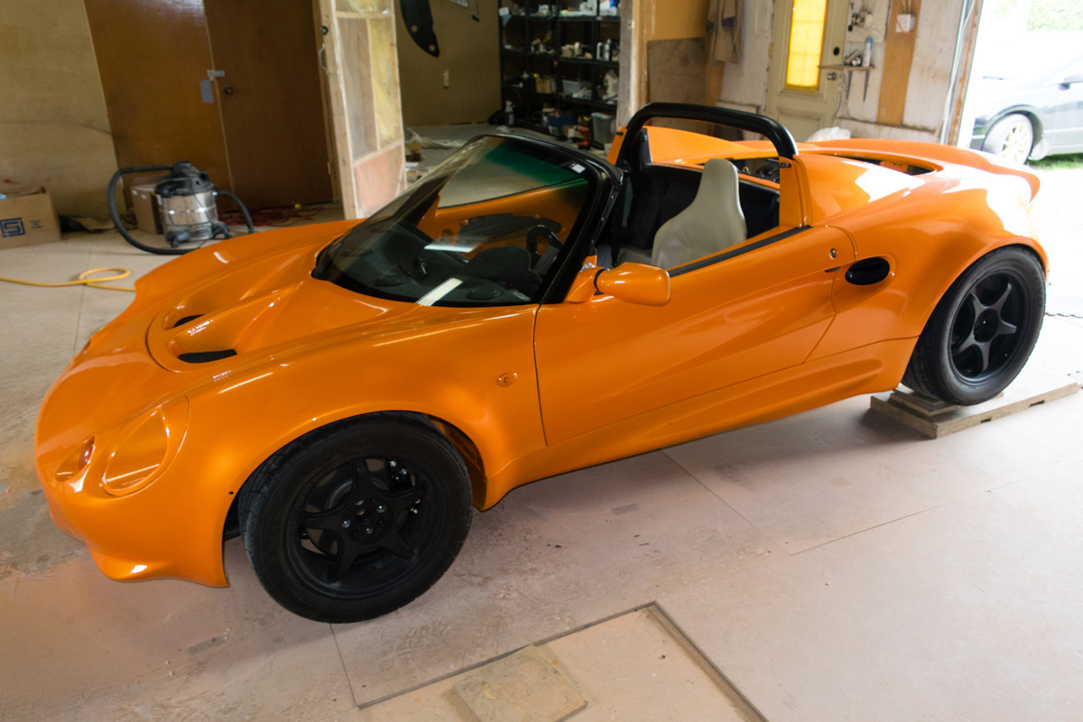

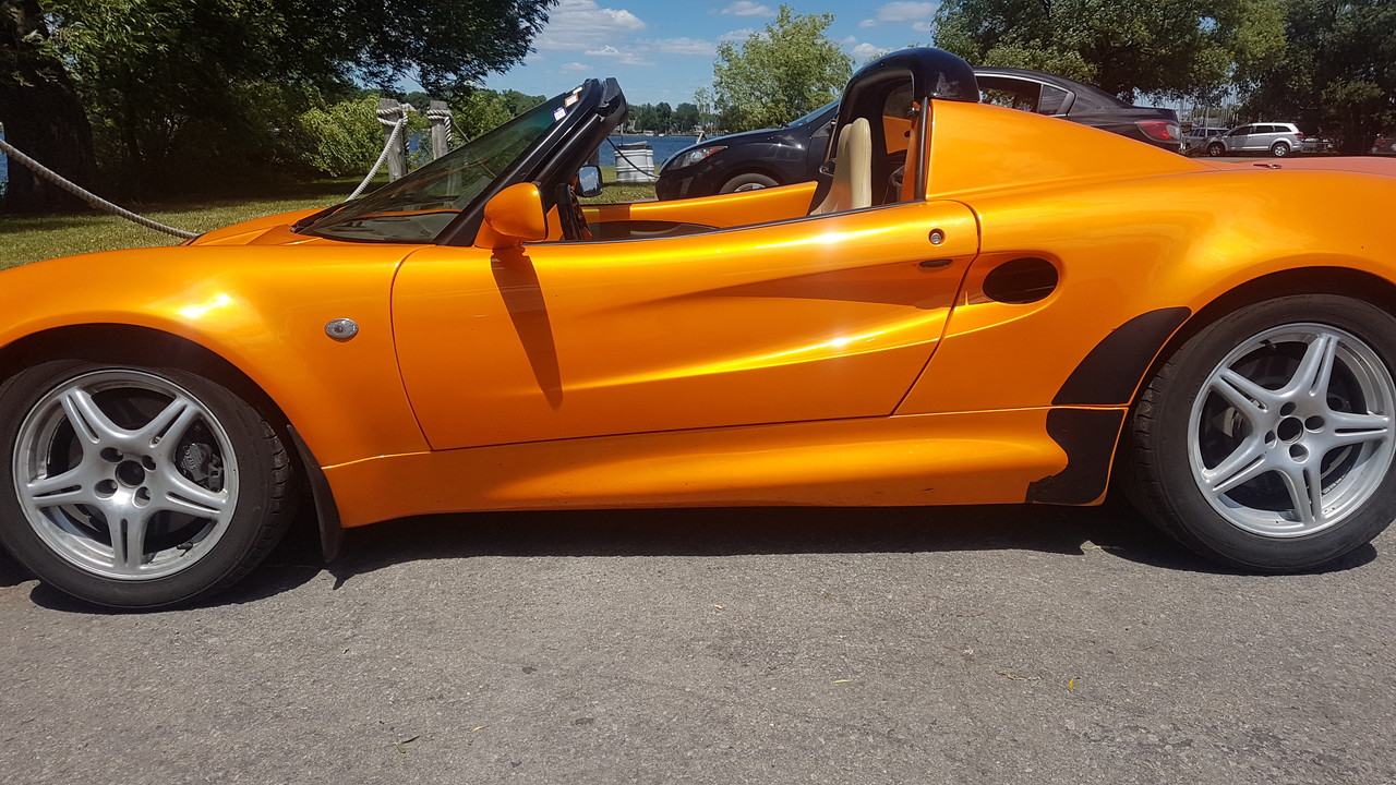

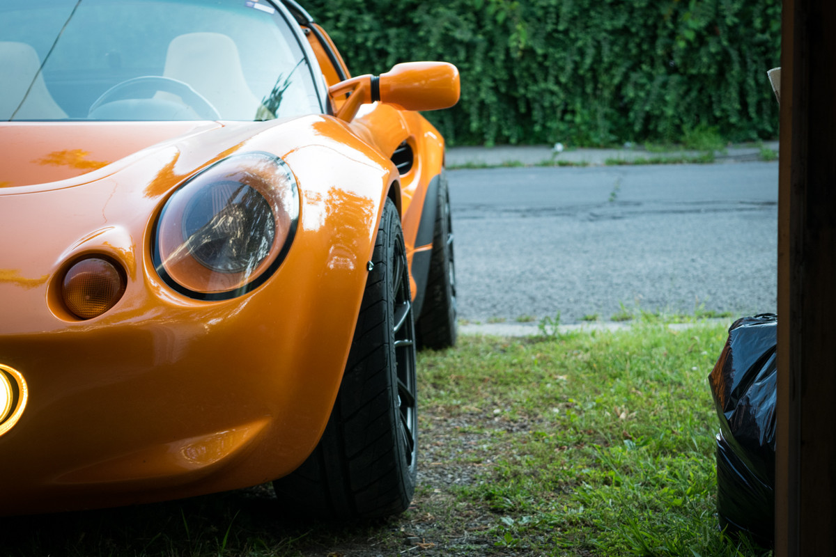

I chose to paint the car Sunset Pearl from House of Kolor. A nice orange with pearl that goes to gold under bright sunlight.
After that I spent the winter refreshing the front and fitting a new ali rad and replacing the fan. I slowing started planning my K24 swap and bought a few things here and there. I also tried very hard to fit 15x8 and 15x9 wheels with 225 & 245 width tires but could not manage. The fronts would rub terribly on the ouside and also rub on the swaybar on wheel lock and on the rears the wheel would rub on the wishbones :eek: I also needed like 40mm adapters at the rear...

I recently remanufactured the sandwich plates for S1 owners that had bobbins corrosion problems.
