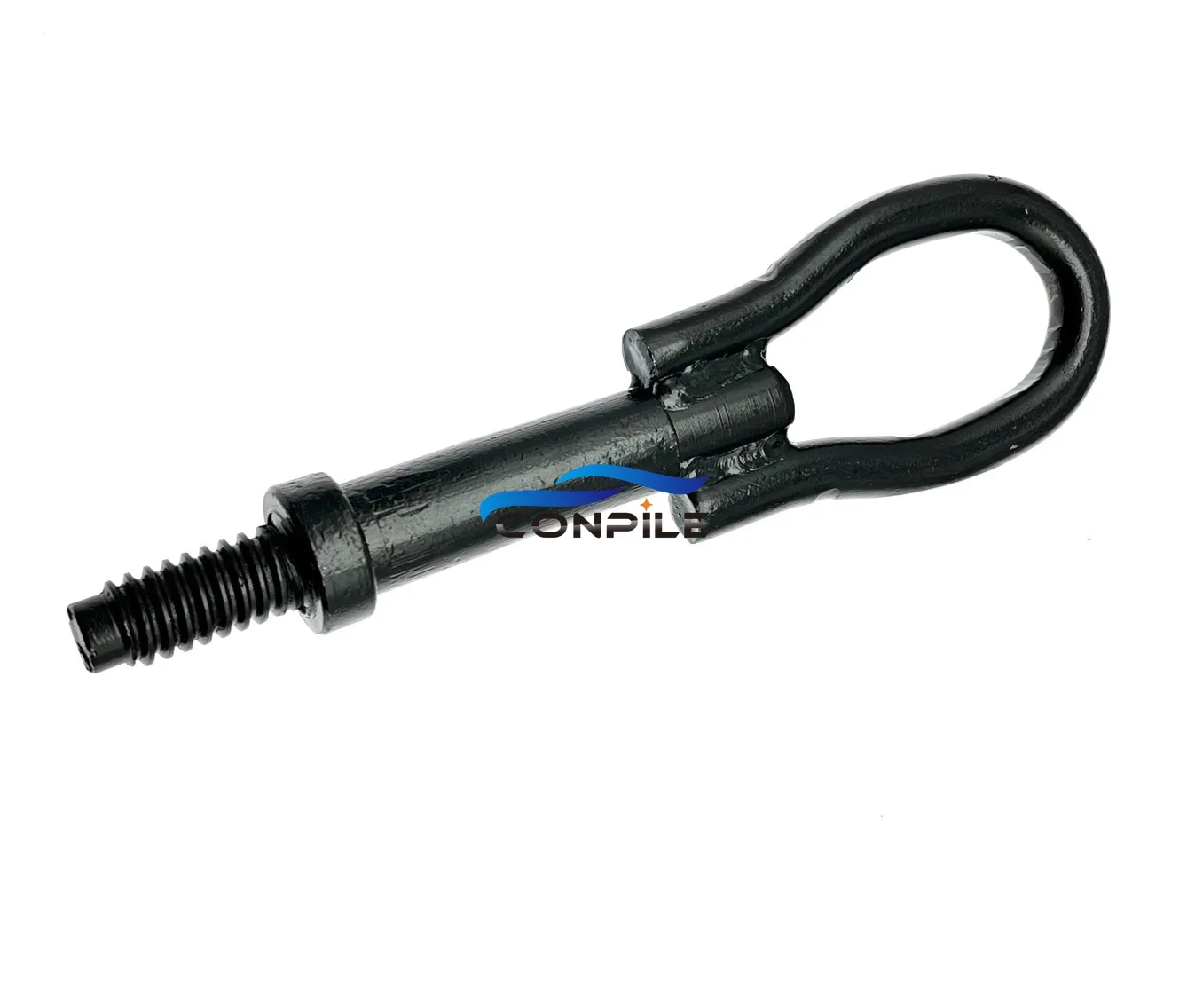

As a direct alternate to having to purchase any generation Evora's front tow hook, you can instead choose to order the likely just as difficult if not harder to obtain tow hook from a 2015+ Ford Focus RS. I know, I know... But please stay calm and hold your praise for a moment as it's important to note that the tow hooks from every other Focus model will not work, only the specific tow hook from the RS model is a direct swap due to being the only LH thread type. Even the overall length is right about at dead nuts to the Evora's.

That’s just another one of the many cheap all aluminum Chinese versions that are questionable to pull an electric Barbie PowerWheels Jeep, much less your Evora.
There are a few legit versions of a well constructed D ring tow hook out there made with the proper materials and tensile/yield strengths befitting of the tow hooks main purpose.
Unlike the Christmas tree ornament versions, these real tow hooks are usually pretty pricey for what they are. I believe the OEM version is around $100 or so, whereas many of these can run in $200 range depending on brand. But you can find good ones in the $125-$150 range as well depending on the modding popularity of the platform it’s for. For example the R35 GTR has a completely unnecessary number of options to choose from.
I chose the ZL1 add-ons premium version D ring tow hook for the Focus RS. They make quality stuff at very reasonable prices.

looks fairly well made from steel, not a Christmas tree ornament. The construction looks identical to the actual Ford part.
Yeah, that first pic looks like it and to be correct overall length, and assuming it's correct thread size/pitch and LH threads, and also assuming it's metal composition doesn't originate from melted old shopping cart baskets, and also that its not riddled with porosity from a low pressure cast mold, and also that those 2 fillet welds holding on the eye are worth a damn with adequate amount of filler material and no lack of fusion/penetration or cracks etc., and also that the black oxide coating is worth a damn and has at least some form of added post treatment.
But, I mean outside of those few minor details you should be good to go. That stack of nine one dollar bills will go a long way in providing some peace of mind when your flatbed guy is winching your Evora up the ramp with only that little stick from Alibaba separating your car from the forces of gravity.
Oh, I have the OEM one in my boot for just such an occasion. Near as I can tell, thread is correct, and it looks identical to the Ford part, which probably comes from the same factory in China.
Bigger problem: Tow truck driver refuses to use it because the last time he towed a honduh with one, it snapped off and made big problems for him. When my Elise was totaled by the f'in kid in the Jeep, the flat bed guys showed up. I took the tow hook out of the boot, installed it and pointed to it and told them to use it. They really didn't want to. As I was now talking on the phone with one hand and holding direct pressure on my large scalp wound with my dress shirt, I told them again that hooking onto the A arms would break something and to use the tow hook, that's what it was for. They reluctantly used it to pull the car up on the bed. My wife showed up and off we went to a hospital to get 10 staples. I could have done a better job with a mirror, sewing needle and fishing line, but that's another story. A day or two later, I go look at the car at the body shop and my splitter was now broken into several pieces. It was fine before the wreck. When the tow truck drivers dropped it off with me not there (trying to get my scalp sewed up,) they put the hooks on the suspension.
