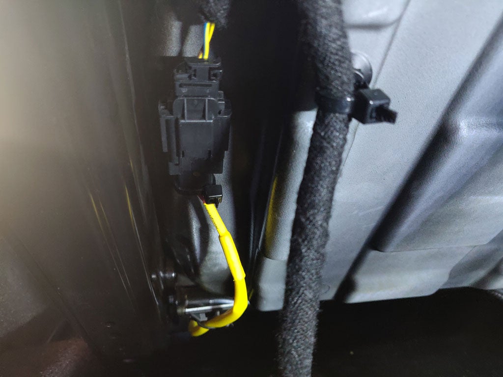

For the benefit of others who may want to do this, here are some notes. First, a photo of the seat heater connection:
Note that the two adhesive tyraps holding the two heater harnesses are hanging in free space. That was a common theme under the seat. The adhesive mounts are worthless, they do not adhere to the seat at all.

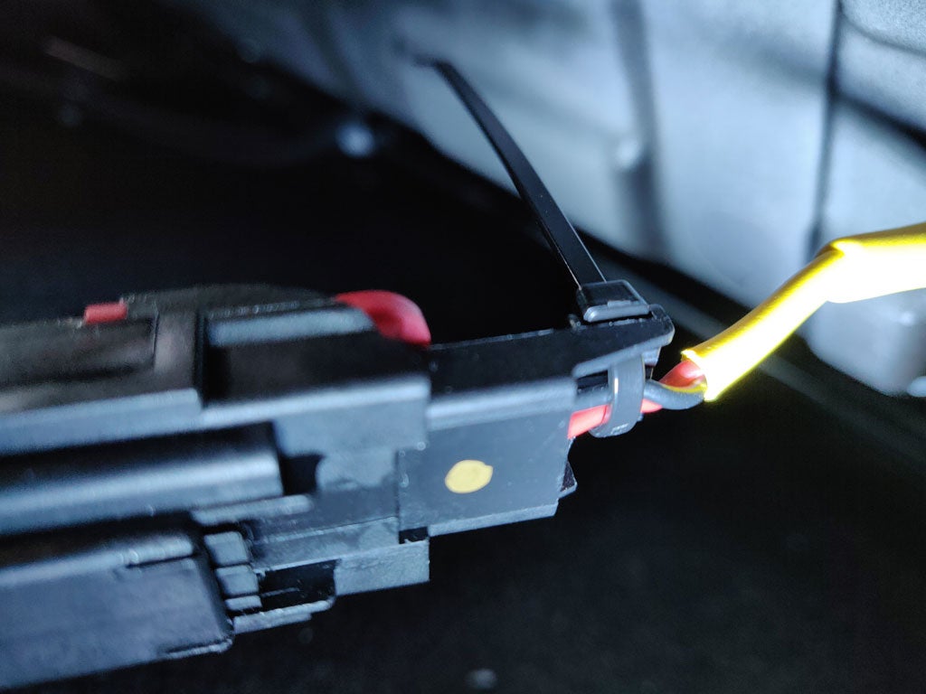

Next, a photo of the SRS wiring harness and the connector in question:
Look toward the bottom of the photo (which is the rear of the seat) and you can see another of those adhesive ziptie mounts, hanging in free space. Zero adhesion. However, the SRS harness and connector are held in place by three zipties which are themselves held to the seat by three of those push-in mounts like so many other automotive trim pieces use.

In my haste to wrap up documenting my under-seat connector adventures I forgot to mention that I did find a broken tyrap on the seat SRS connector. I replaced it with an identical one. Here's a photo just before I trimmed off the excess material:
This connector does NOT come out of the central housing... you can see the red retention clip in the photo above. The connector that does come out is on the other end, and is tied to the vehicle wiring harness.
The tyrap's strap had been snapped but the tyrap was still in place on the connector. The red and black wires have little grooves in their insulation where the tyrap pressed against them. No idea if the wires were tugged hard enough to snap the tyrap (that would take some serious force) or if the tyrap snapped during installation. I almost missed it, so it's easy to understand how it could have been missed in Hethel during vehicle assembly.
I mechanically checked that the wires were still engaged in their contacts. I did NOT electrically probe the wires to confirm continuity, as I don't know what signal is used to trigger the airbag and I wasn't interested in accidentally doing that. It's likely well more than my Fluke meter uses in its low resistance ranges but just not worth the risk.
Now that I look at it, that photo is useful in another way. Precisely where to use the screwdriver (mentioned above) is not necessarily clear from the Lotus illustrations, so here's an annotated photo:
The locking tab area is a bit out of focus because I took the shot to illustrate the tyrap, but everything is still visible. The point is that the screwdriver goes into the slot nearer the central housing body ("under" the locking tab), not in the slot between the locking tab and its protective cover. As a reminder, once the locking tab is lifted out of engagement it is the vehicle harness connector on the OTHER end of this assembly (not visible in this photo) that slides out of the central housing. The SRS connector (shown above with the red and black wires) remains in the central housing.
