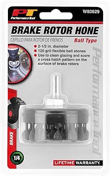

BTW, I always used to poke a nail thru all the drill holes after track days. Amazing how much stuff was in there!!!
Is that a drill attachment looks great id like to do something like that next time what all do I need?
