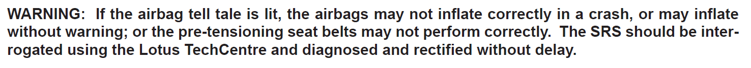

Don't ignore or tape over the airbag light. It is my understanding that when it is lit, the airbags are non-functional.
I need more context. What gives you this understanding? I just can’t believe this is true. When 50% of your automobiles (spitballing here, of course) are driving around with an airbag light on, it’s just hard to imagine that a company’s lawyers could think this isn‘t an existential liability risk to the company if any of those cars are in an accident and the airbags don’t deploy.
This is what the service notes state:
I would defer to your knowledge about these kinds of things. But here is my interpretation of this whole cockup: What is in the service notes is how the airbag tell-tale light should function and is its purpose. But that’s not how it is functioning. There is some electrical gremlin that is causing this light to activate on a large portion of Evoras in the wild. The light itself is obviously not going to cause the airbag to not deploy—it’s meant to indicate some underlying problem that might do so. Instead, it’s coming on because of a low-voltage trigger and/or random Lotus electrical nonsense.
The only way we will ever know, if only anecdotally, is if we can get somebody who has been in an accident with the airbag light on to tell us whether the airbag deployed or not. Of course that doesn‘t mean that it always will deploy just because of one case, but at least it would be a real world piece of evidence. I stand by my earlier reasoning—we have not heard any testimonials of airbags not deploying in 10 years, despite loads of evidence of airbag lights on many cars. We’ve also not heard any examples of Evoras having an airbag inflate without warning. In the absence of any better evidence, I’m not going to worry about the tell-tale light.
I agree with your assessment as well. I was just posting the verbatim from "the horse's mouth" so to speak.
As for voltage issues, the light is supposed to exhibit a different behavior:

Because so many of us have dealt with airbag lights, I reached out to Dave Simkin, National Technical Manager, Lotus Cars USA. Below are his two replies, verbatim, reacting to the original post in this thread. Helpful information. Bold accenting is mine:
First reply:
It is most likely the seat airbag resistance reading high. GM suffers with the same concern to the point they eliminate the connector and hardwire the seat bag. We do not condone this and cleaning / Resecuring the connector will take care of it. We do put additional fixings to eliminate the possibility of the connector moving when the seat is moved back and forth on the runners. The connector itself has a specific way it is released and I can email that to you tomorrow. Once the resistance is corrected the light should go out. While the light is illuminated the SRS system is inoperative

So after all this time and considering it happens to damn near every Evora, you'd think they would mail us the directions to disconnect , reconnect the connector........Maybe GM had it right because a non functional airbag due to a defect in a connector sets up Lotus for a BIG liable lawsuit if someone gets killed. Bottom line, the system is too complicated for its own good.
Even that doesn’t make sense to me. So are the seat airbags inoperable, or a fault anywhere in the SRS makes ALL airbags inoperable? Why would they do that?
